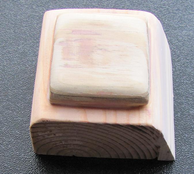

OK for those of you that have tried sometimes years to find one of the single hardest pieces to complete your Cylon costume relief is here. Well to a degree it has arrived, well coming soon. As many of you know that the G&M battery belt that is screen accurate has 7 battery belt box section. A limited 6 battery belt box was mad also, and some people have tried the Cine 60 6 - 7 - or 8 battery belt box also. This is an OK alternative, but does have its problems. Well after having this idea on the back burner a while I finally stepped up today and took the needed next step to bring access to those still waiting for their belt. Today I made a buck (wooden copy) of the Cylon battery belt sized to the Cine 60.

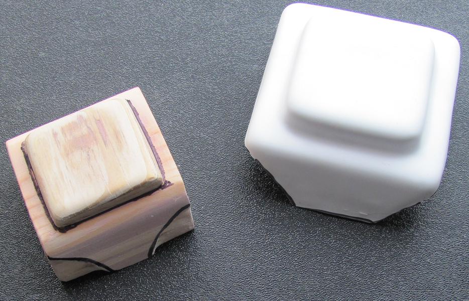

I made the wooden buck to scale close to fit the same look as the larger G&M battery belt box. I outlined some of the areas in black marker to see the high lighter area better in the photo next to an original sized box.

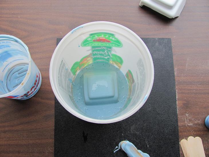

I poured the liquid latex over the finished buck. I'll made fiberglass copies myself that will be for sale soon. I'll also get together with C.O.R.A. and see if he can made pulls that can be sold separate, or included in his kits as a alternative. I'll send him a link so he can see what is up. Oh hey C.O.R.A. glad you stopped by. :grin:
Rubber pour to make mold
Detail still needed in this photo
Side by side

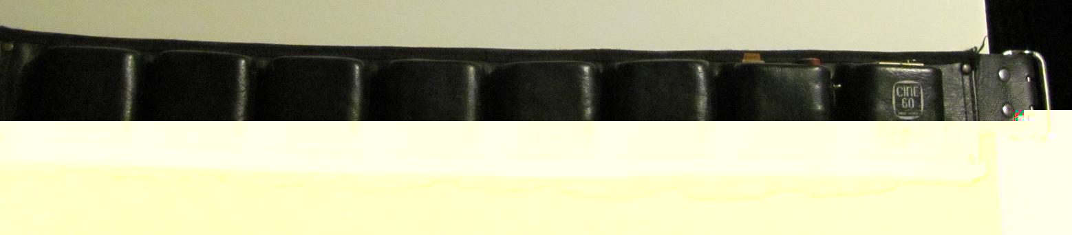

This is a vintage Cine 60 square 8 section battery belt.

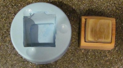

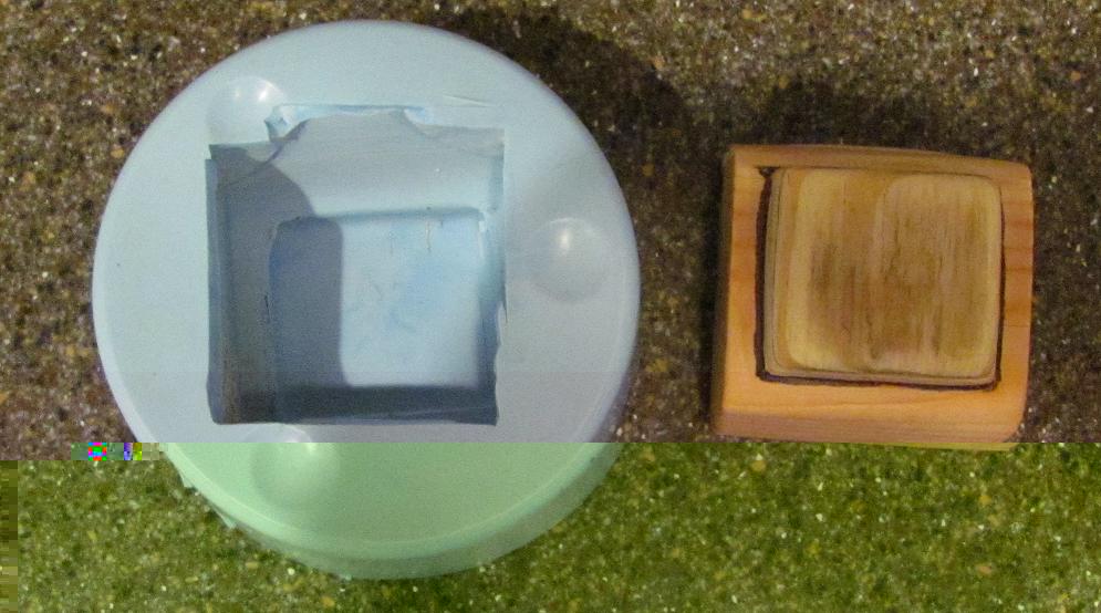

I just pulled the buck out of the mold, and it looks great inside, and out.
