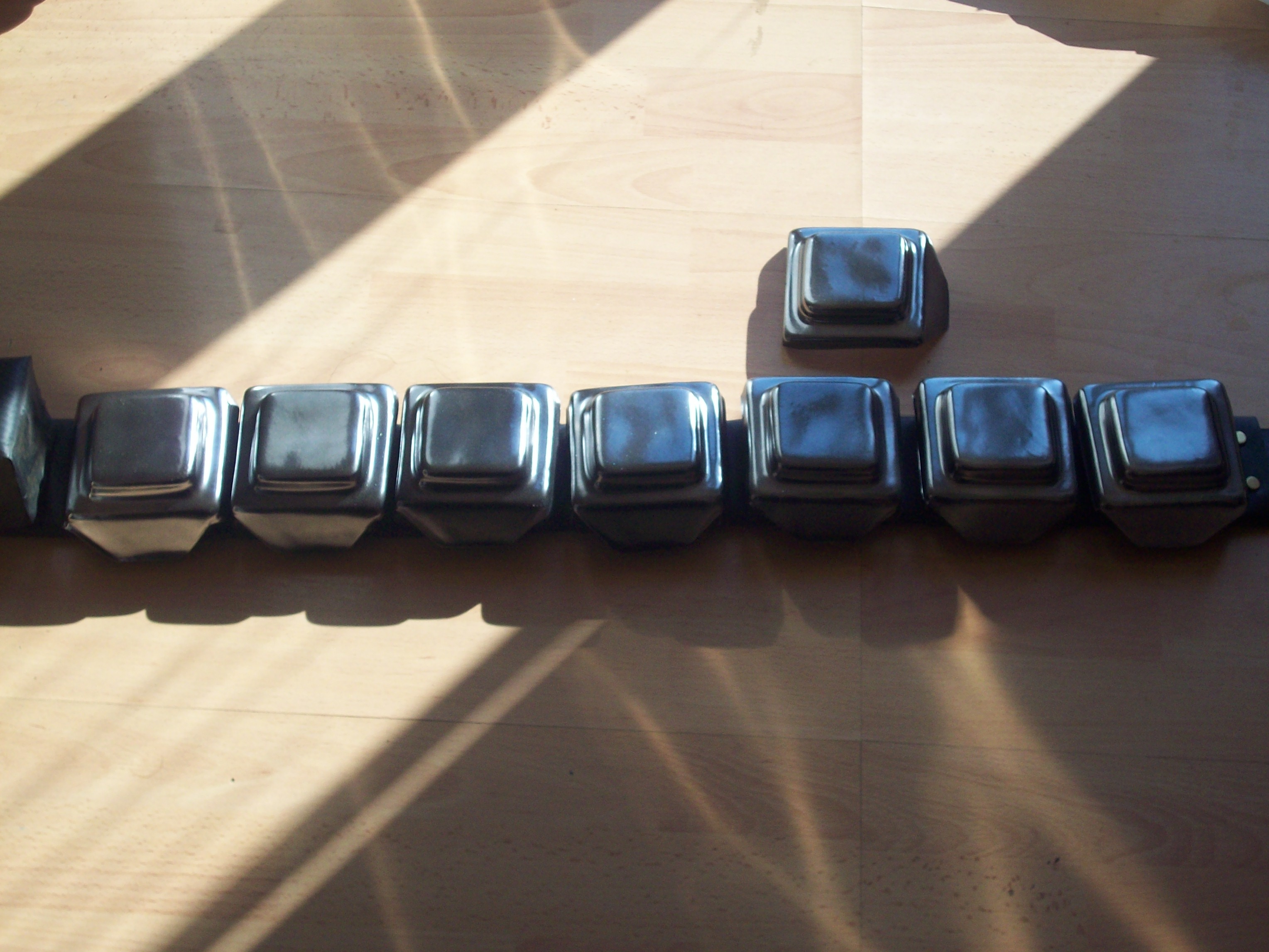

Post by rustycylon » Sat Jul 06, 2013 12:17 pm
I had a dabble with the alclad2 chrome paint today :cylon:

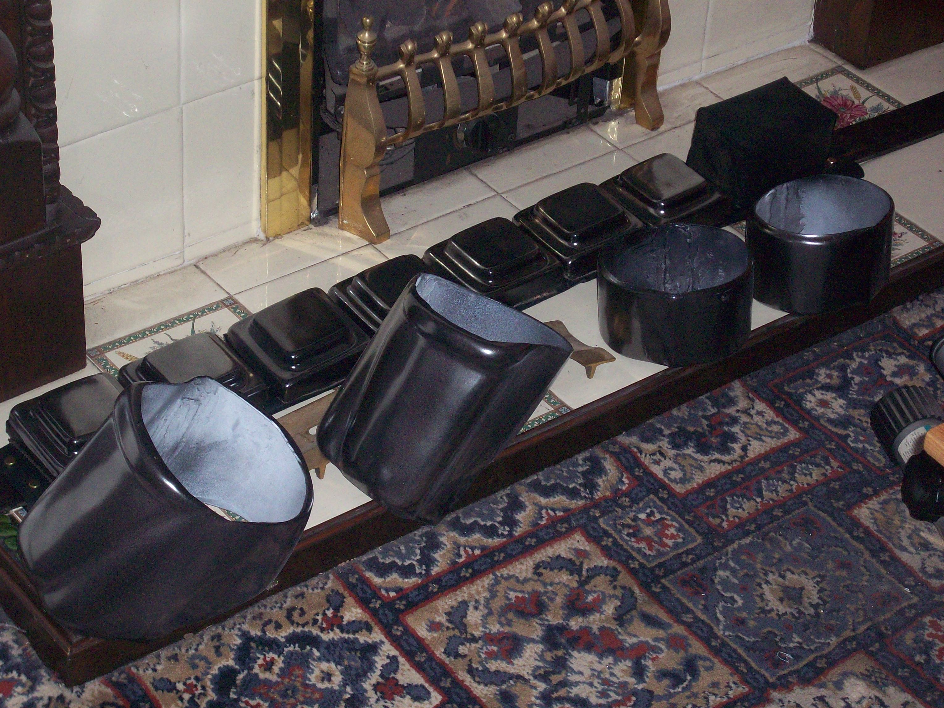

Post by rustycylon » Sun Jul 07, 2013 2:34 am
I grey primered the belt buckles
left it to dry a few hours then
flatted down with wet and dry
I sprayed it gloss black with a spray can
left it 10 minutes
then sprayed a very light dusting coat of chrome with a airbrush pressure very low
left it a minute or 2
then sprayed a second slightly heavier coat of chrome pressure still low
left it out in the sun to dry for a couple of hours.
if you think you have sprayed enough chrome paint on you will probably find you have infact sprayed on way too much and what you will end up with is dull silver
