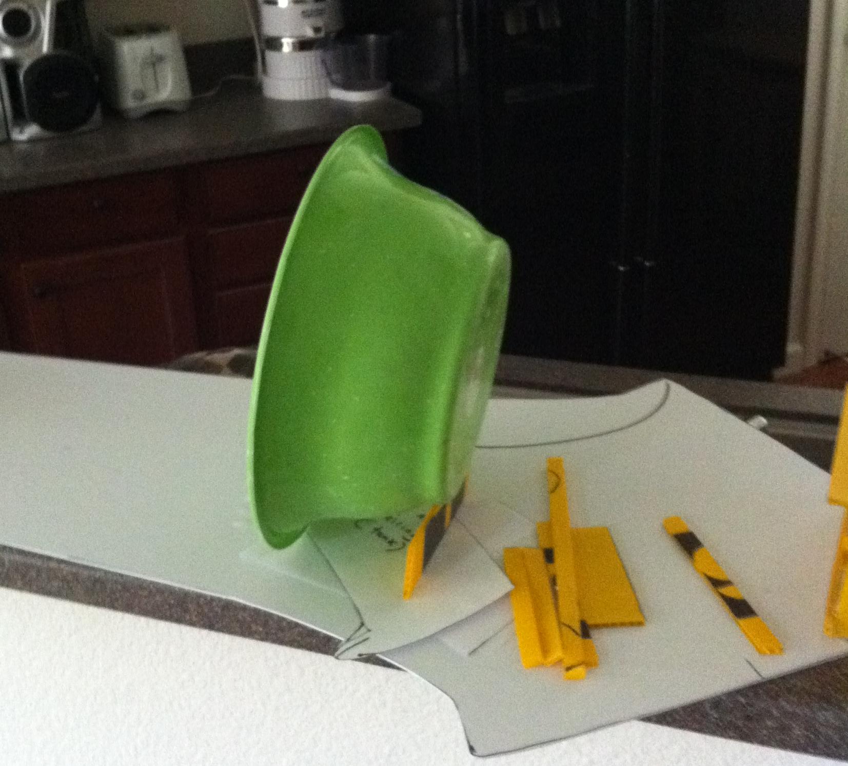

OK I was thinking about the entire bike project, and was talking with Brian (Hand-Schaub) when he stopped off last week. He was telling me how it looks like I took on the hard stuff first. I thought I started with the easy stuff myself, and he said to him the engine cowling section looked like the easy part to him. I said I was going to leave that to Mark in Orlando to do that. While he explained a bit more, and my thoughts are now he is in secret working on the engine cowling section, but I am sure to find out after he reads this. Anyway I digress, and I thought about the section, and study it. It now after Brian's input I looked, and started to take note that seems to be made from many off the shelf parts, and with the front cone section a large bowl. Here is a bowl I use as my water bowl for wet sanding. What do you think? Anyone have a 1979 plastic bowl around the house like used for the engine air intake.

If you want my opinion, the bowl is a good idea but the one you have there is too curvy at the bottom and the top flares.
Michaels use to carry styrofoam Balls and cones for craft projects and if they had a cone big enough you could use one and cut it down.
The air intake on the ref pic looks like it has very straight draft lines and your bowl is curvy.
Another way to do it is to use the blue foam, Make a block of foam by stacking and glueing several pieces together, stack them high enough for the height and rough squared base slightly bigger in diameter than your finish line,
Find the center and make a hole from the top to the bottom, Then use a pencil compass to draw your large circle on the bottom then your small circle on the top, Then start cutting, you will get a natural shape draft by removing the material on the sides and sanding between the edges of the circles.
Just the way I might do it

I'm with big Al on this one. I think you'll end up with two much leg work and
You would have finished before you found a part that was only close. You could cut the top od and the bottom od and use heavy gauge paper and tape to make the shape then glass away and do the cuts later.

Sorry if I suggested this was the bucket I was going to use. It was what I have on hand you use. No way would I sculpted this into the correct style. I have one of the correct styles already, just it is on the boat. I just need to double check with the dimensions, and it is a go.

Cool if you already have one. I was just giving my approach from scratch. 2 foam core disks and stiff cardstock paper. How's the boat! Envious... I could use some chill time. Keep up all of the great progress!
