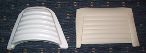

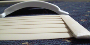

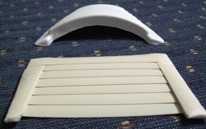

Well, my own first attempt at a true vented mouth grill - was a flop (photos to come tomorrow - I am TIRED now). I used slats from an old set of vinyl mini-blinds. I cut and taped together an arrangement that mimics the grill; however the blinds do not lend themselves to bending at all (the grill has that slight curve to it).
A completely flat grill looks just totally WRONG
Post by Cylon-Knight » Sun Feb 01, 2009 1:58 pm
Here we go, the Mark I Grill (the flop) photos I mentioned above.

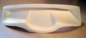

Grill from my kit, next to mine
You can see the curve it should have, and the curve it DOES NOT! :oops:
My grill all together has lost its "vents" (they are there but all pushed together the air-flow wouldn't happen).

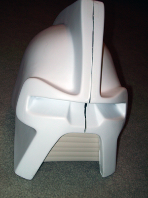

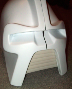

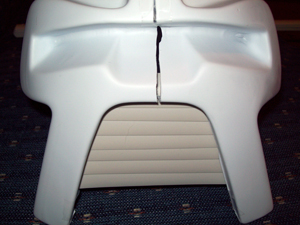

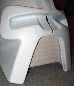

Mark I grill in the helmet - a few views. Not all THAT bad... but not 'right.' :roll:

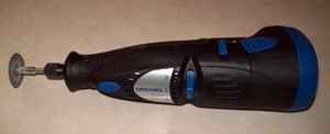

With a Christmas gift card and some birthday money, I got a cordless Dremel to help with my Cylon.
My new toy. (BEWARE! lol)
Worked like a champ on the hard plastic the eye is made from. I got the eye slit cut out in less than 10 min, and on a single charge. (I did snap one cutting circle into three parts :roll: learned I had to cut a bit slower).

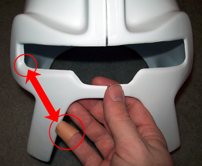

I did some more trimming last night on the eye area with my X-ACTO knife. I didn't finish it yet. (Note the circled corner I have yet to clean up, and the band-aid. I'll let you figure out the rest :shock: evil robot!)
So far the eye trim work has been the most work, and I'm still not done with it so the hard plastic eye will fit right. Even after the trim work It will need some putty to get everything smoothed out and looking right.
