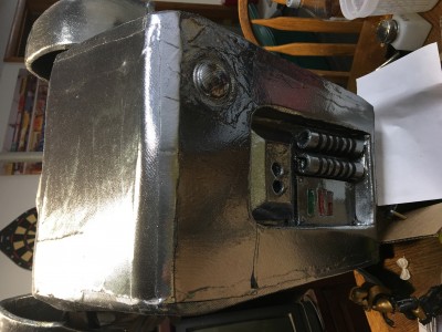

I've completed my Arduino Larson scanner, backpack, gloves, and chest armor here is a picture of the chest armor I still need to get pictures of the other parts:

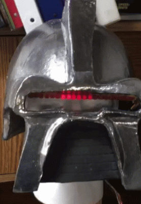

right now the bars are just clear plastic with clear colored backing but I might hook them up to the battery of the helmet and put solid lights behind them. Its been a lot of work so far I am currently working on the forearm shields and arm mechanisms. I am also attempting to make an animated gif on the Larson scanner to post here.

I guess I should have said this, the above "Larson Scanner" is done with an Arduino UNO and a simple sketch for it that another guy wrote several years ago (being a professional software engineer) I modified the sketch so that it is able to run 10 led pairs for a total of 20 LEDS. I also adjusted the time it takes to go from end to end, I think it looks right now for speed. The whole thing runs off of a portable cell phone battery pack that recharges off of a USB port in less than an hour. As such, its capable to run for several hours and you can quickly and simply change out the battery pack. (even a 9v transistor battery works but you don't get much run time) All you need is a piece of bread board and a resistor for the leds all the grounds are tied back to a single one of the uno's ground pins and each LED pair is lit by a single copper wire back to one of the UNO's outputs. if your can solder even half way decent you can make this your self for < $50 I need to perfect a wax diffuser for it and I should have started with REALLY bright LED's instead of the old square ones I had left over from the 1980's
