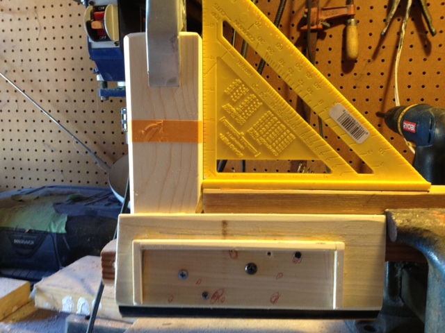

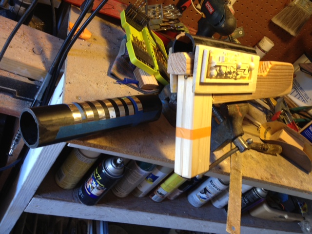

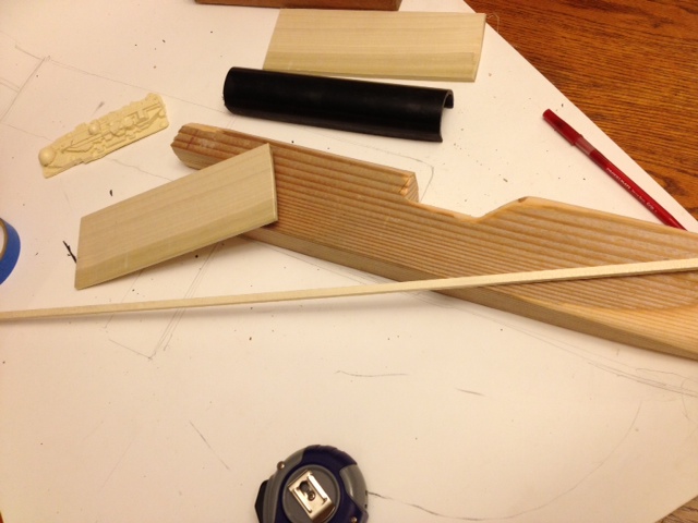

I came down with a cold so I did absolutely nothing yesterday, but today I got some more done. I'm getting to a point where I'll need to vacu-form over the forms in order to start making the final tooling. What you see is wood and plastic mockups which will be clayed up and vacu-formed over. I will then cast fiberglass into the vacu-formed plastic parts to make one piece tooling. I can then tweak and round out the tools for accuracy. In the end I'm having fun with this project because even though I had looked at original samples so much I am amazed how often I go back to the galleries and look at pictures to check myself.

Possibly both. I think I can make the tooling so I t is very build friendly. If the notched tab thing works out then it will be very easy to line up and glue together.
Since most of the rifle is electrical tape I think it will be part of the kit
