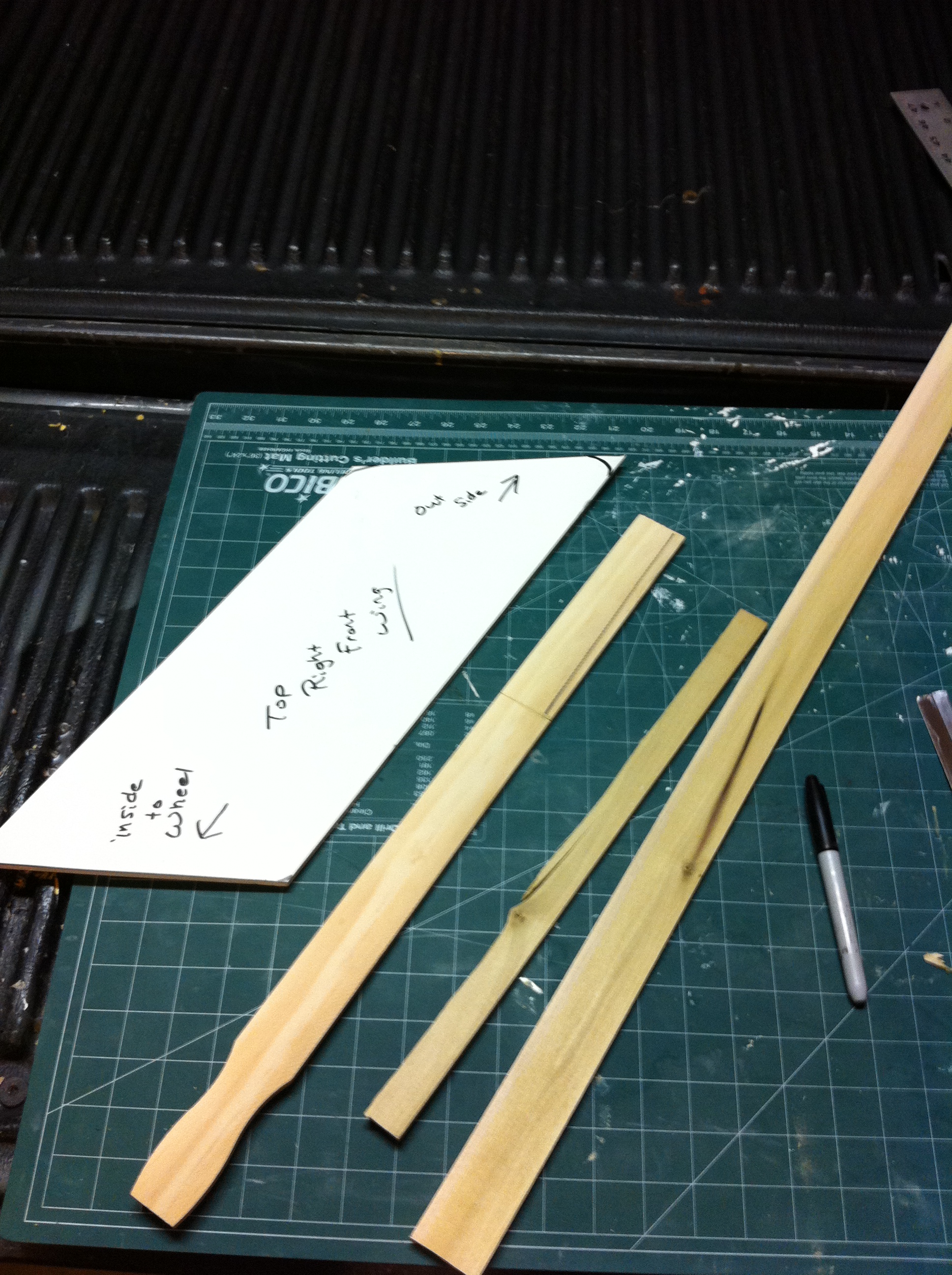

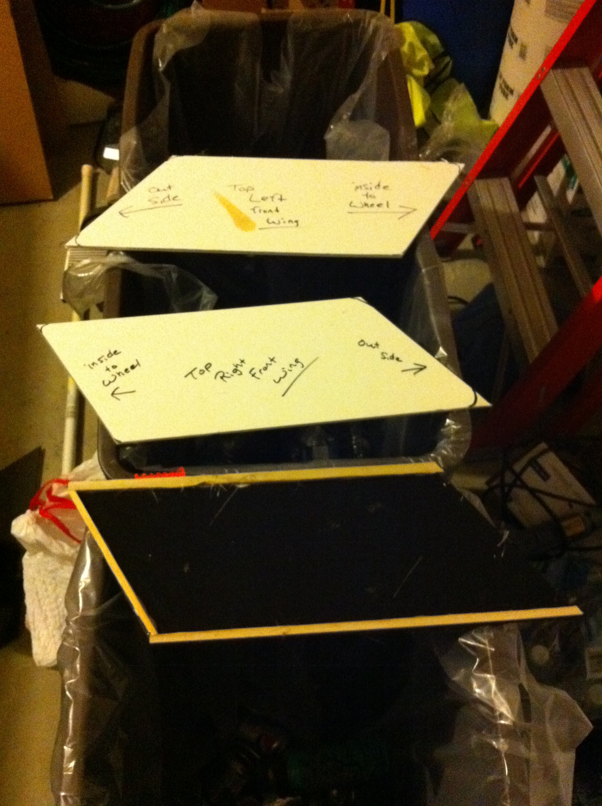

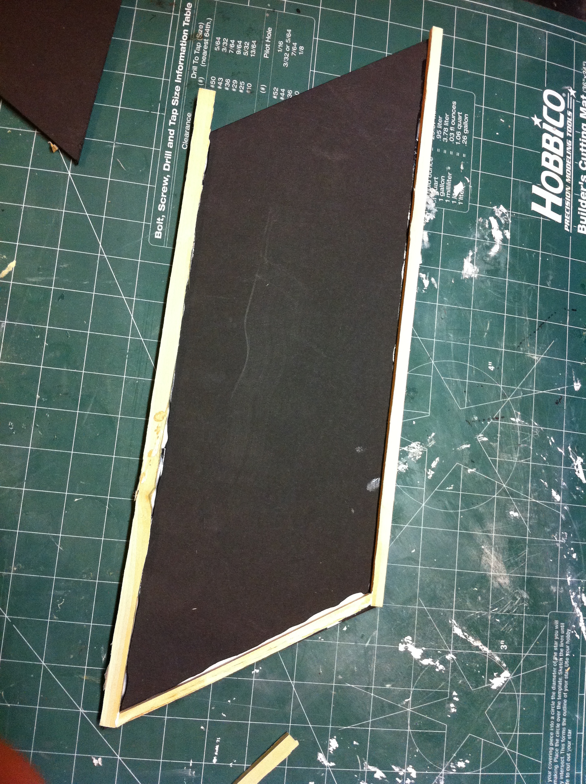

There are three of us that are all forum members working on this somewhat together. I feel a tad out of the loop because they are on the East Coast, and I am on the West Coast, but location is what it is. So I have started on working on the fiberglass pieces. Yeah I guess I need to get bike also, but I am going to see if I can find the street legal version of this bike so I can take it out on the street.
First I started on the front wings. Since that is about as close to the ground as I can get modifying the bike with out having a bike.

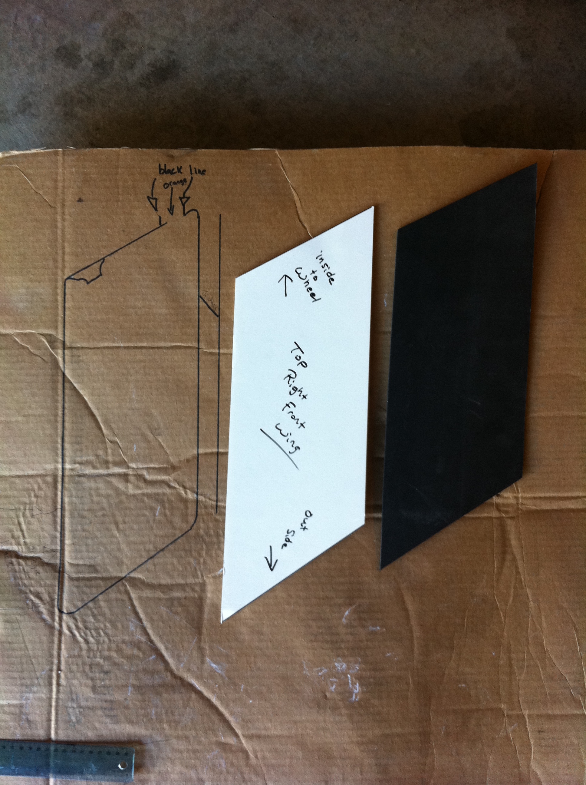

I used foam board as my material, and then took the rough cut pieces in to have custom made metal frame for the wings.
When the metal frames are ready I'll then finish building the wings, and fiber glass coat the pieces.

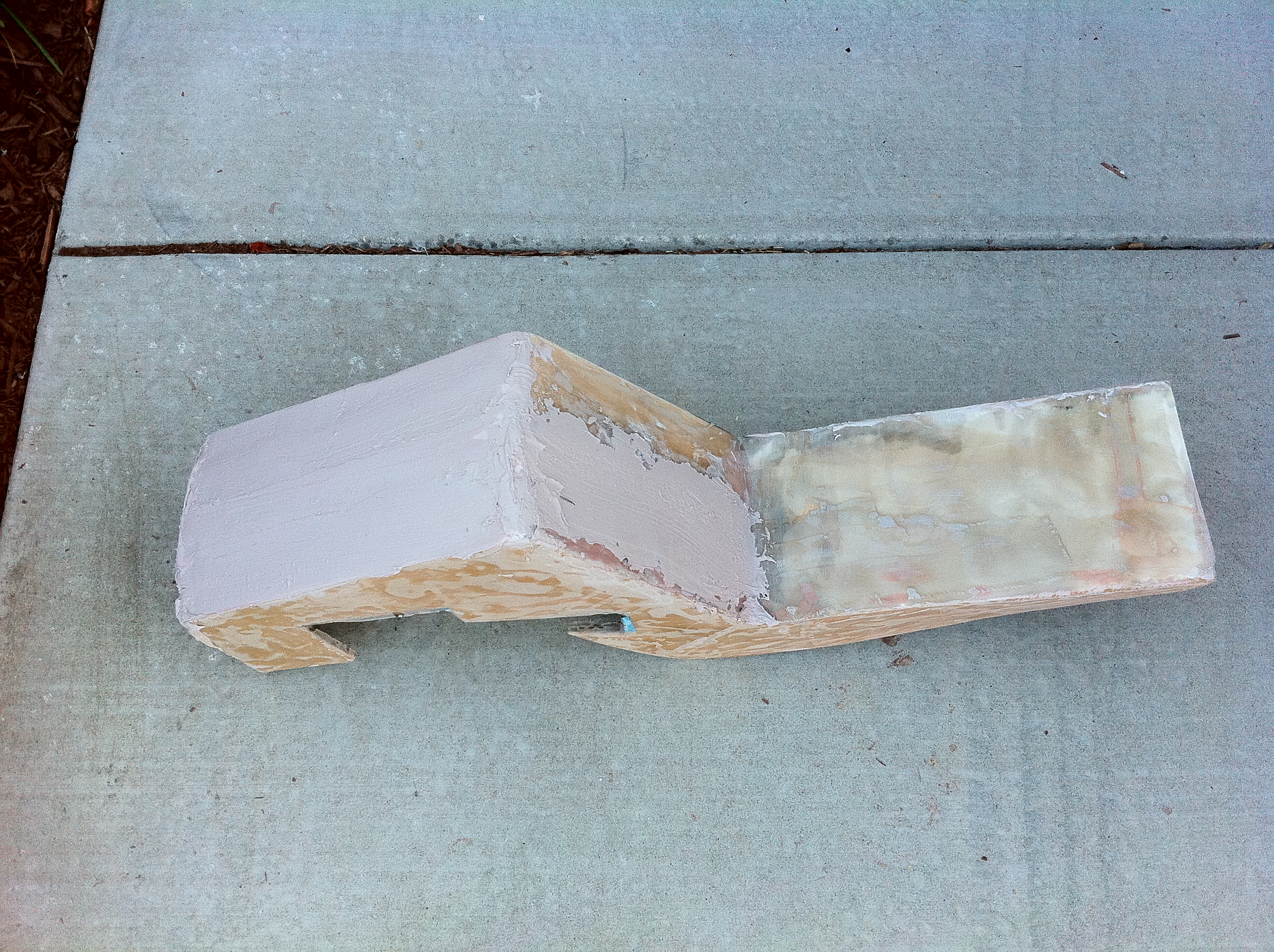

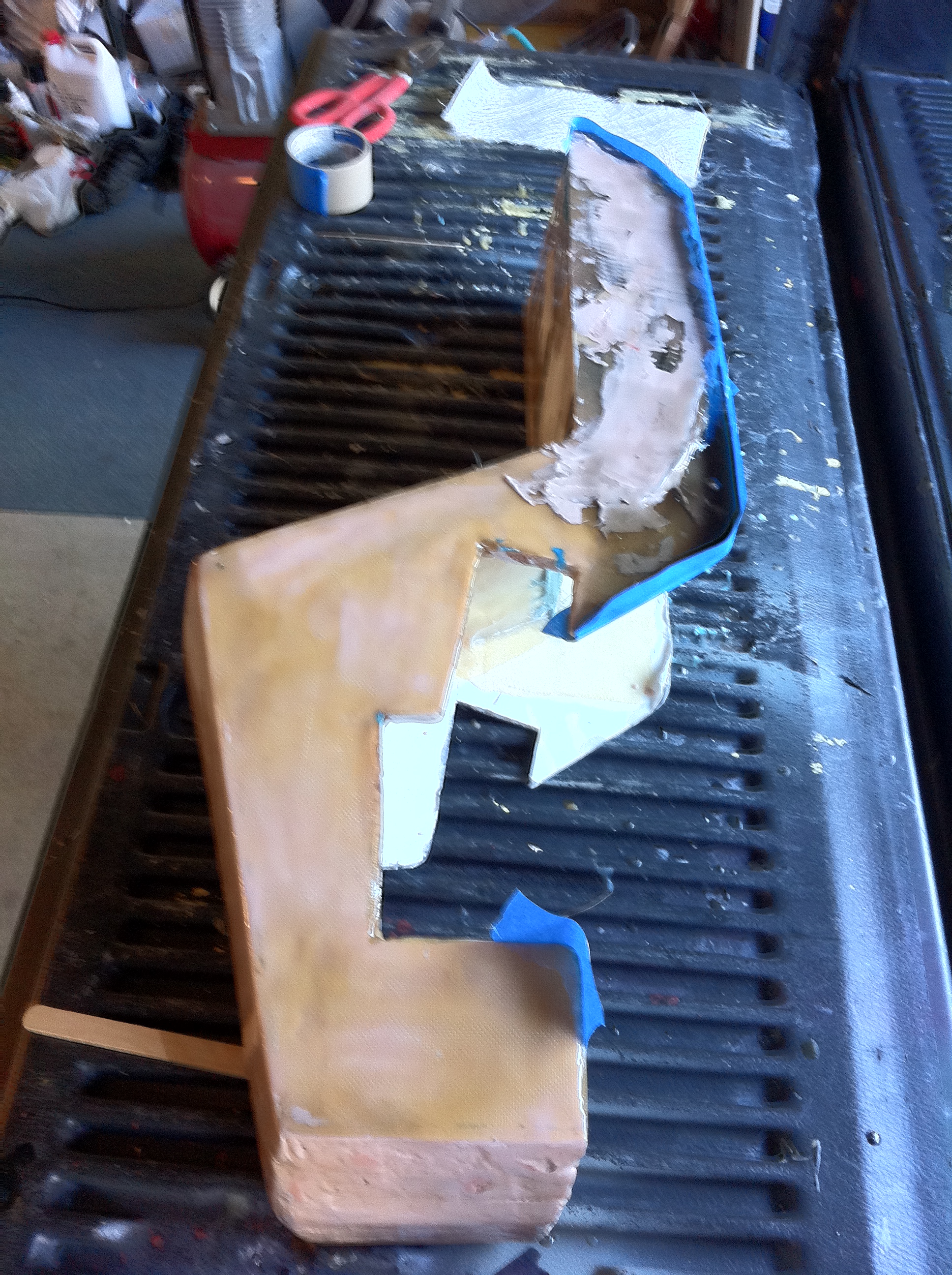

OK I am now working on the seat section. I started out with foam core art board as the frame, and then started with a fiberglass layer around it, and then a mix of Bondo, and fiberglass and so forth. I put one layer down to think, and the heat warped the board. Instead of cutting it off I just screwed a board along the side and filled in with plastic trash, and dried Bondo, and then poured fiberglass in to fill that gap. This piece will no longer be a usable piece but a master pattern to make a mold so the inside no longer matters what is inside.

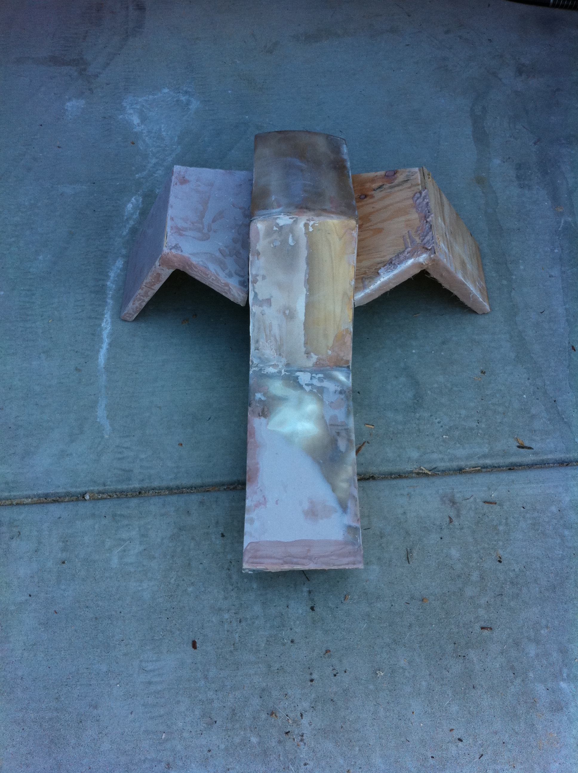

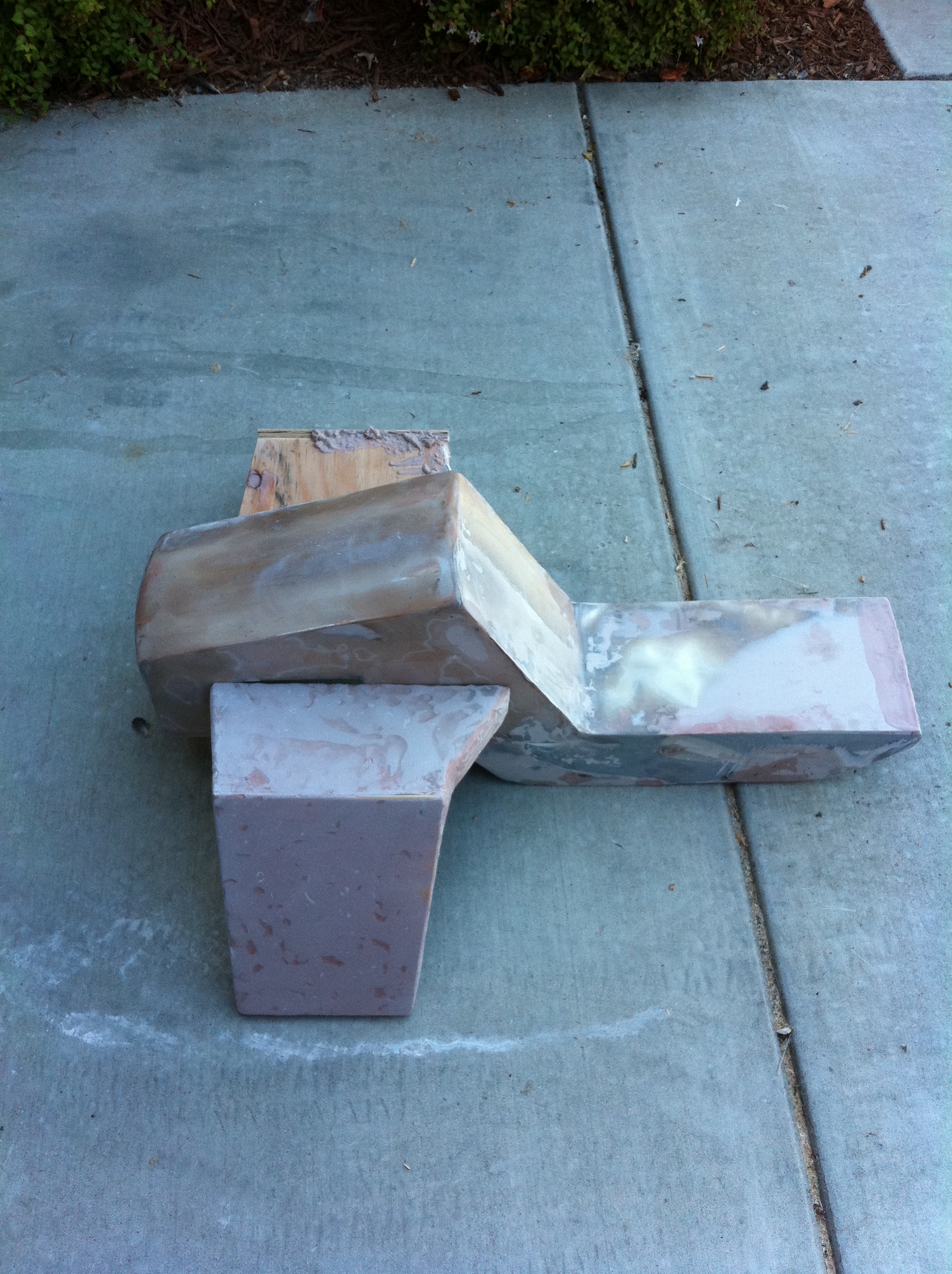

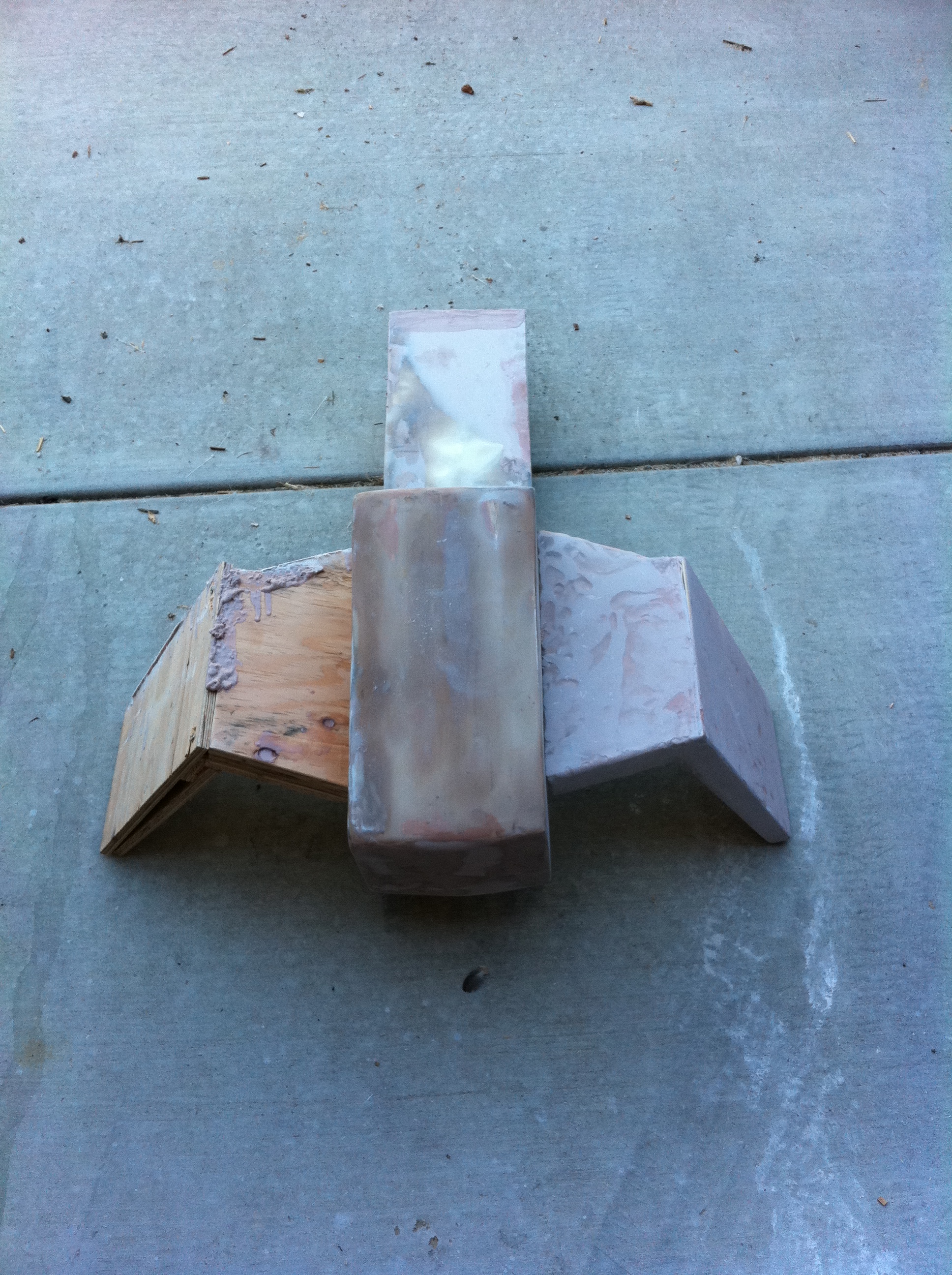

Sorry lacking photos. Just been busy working on the parts. This is also taking longer then I planned out. I thought I was going to get some primer paint down today, but it just didn't happen. I have to go do the socializing things also, and then robbed me of a dozen or so hours over the weekend. I might have completed the target I had aimed if I had that 12 hours. I wanted to detail out the seat, but the closer I get to completion the more I see that needs help. It is me more like I want it as perfect as possible more than close enough, and also had 2 warped walls that had to be built back up. The seat, and the seat back since they are covered by a padded piece of plywood that isn't as critical as the outside pieces that all eyes will see. but I did need to correct a dip or sag on the seat, and dry time is killing me also. Well I did get to finish up framing out the rear wings, and have fiber-glassed, and Bondo mix on the entire right wing while I still have a a ways to go on the left wing. The left wing is framed out, and started the fiberglass and Bondo, but haven't even begun to sand it yet. Anyway here are few photos of the progress I am current with as of now.

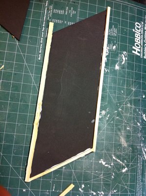

I switched over to plywood on the wings. The foam core method I used for the seat was just taking to long.
