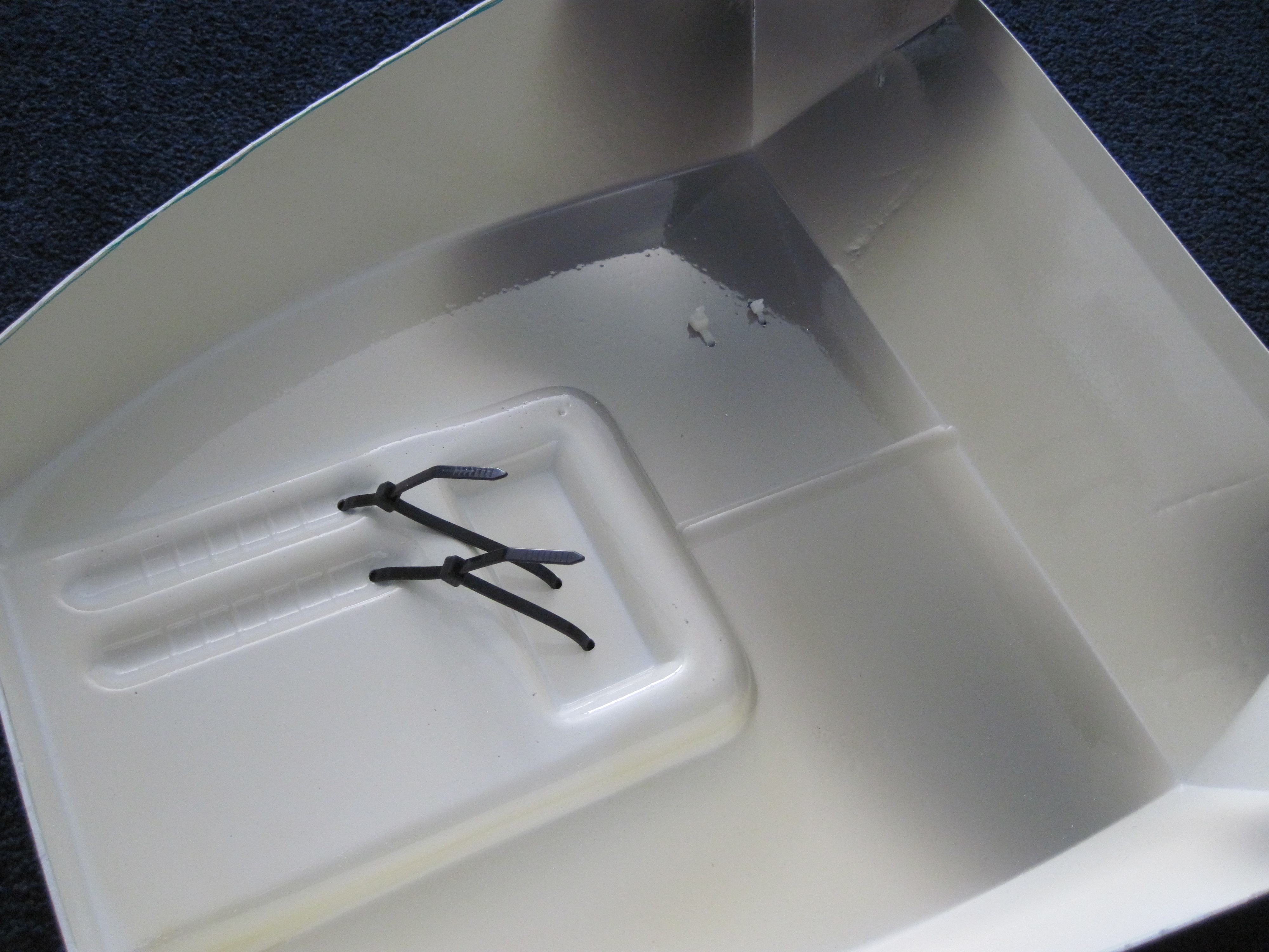

I also used zip ties on the gauntlet nozzle detail. I will show some close up pics soon. I also used the ties on the black circle detail (not sure of correct name) on the backpack. I don't want to be trooping around a con and start to fall apart! Some more pics are due to be uploaded when I have finished some usual work.

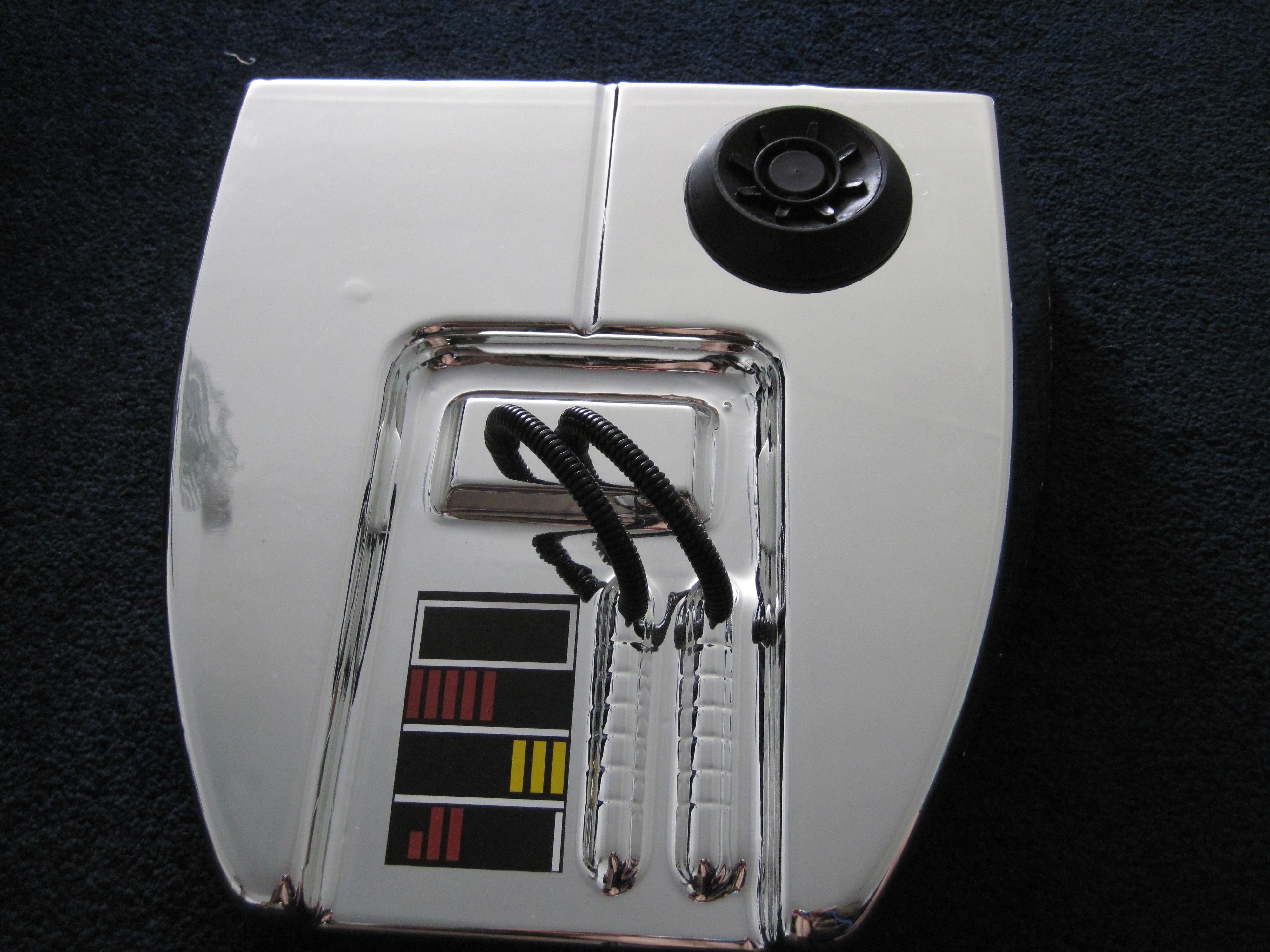

Some photos you may like...
Fixing detail see zip ties
Backpack

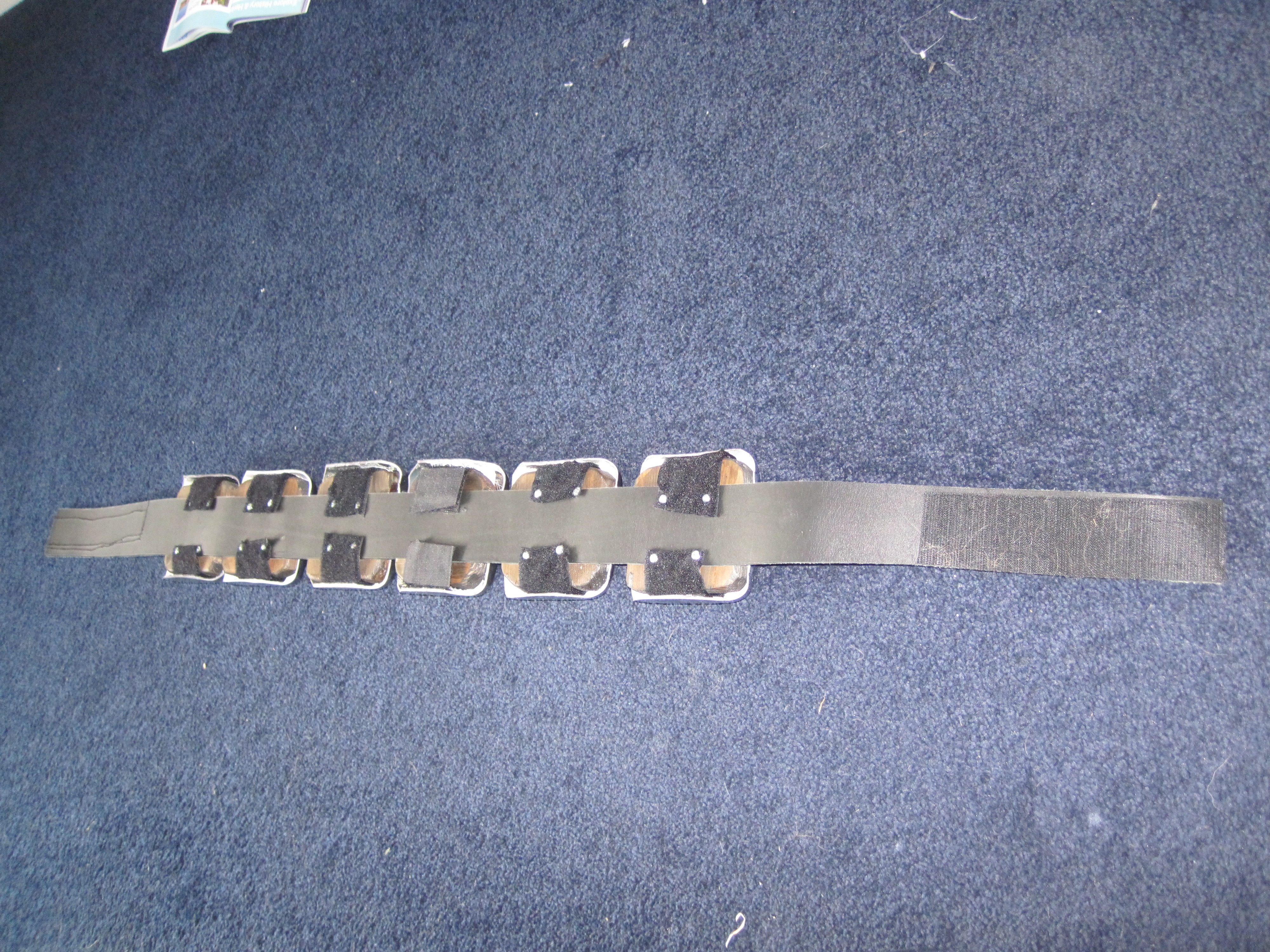

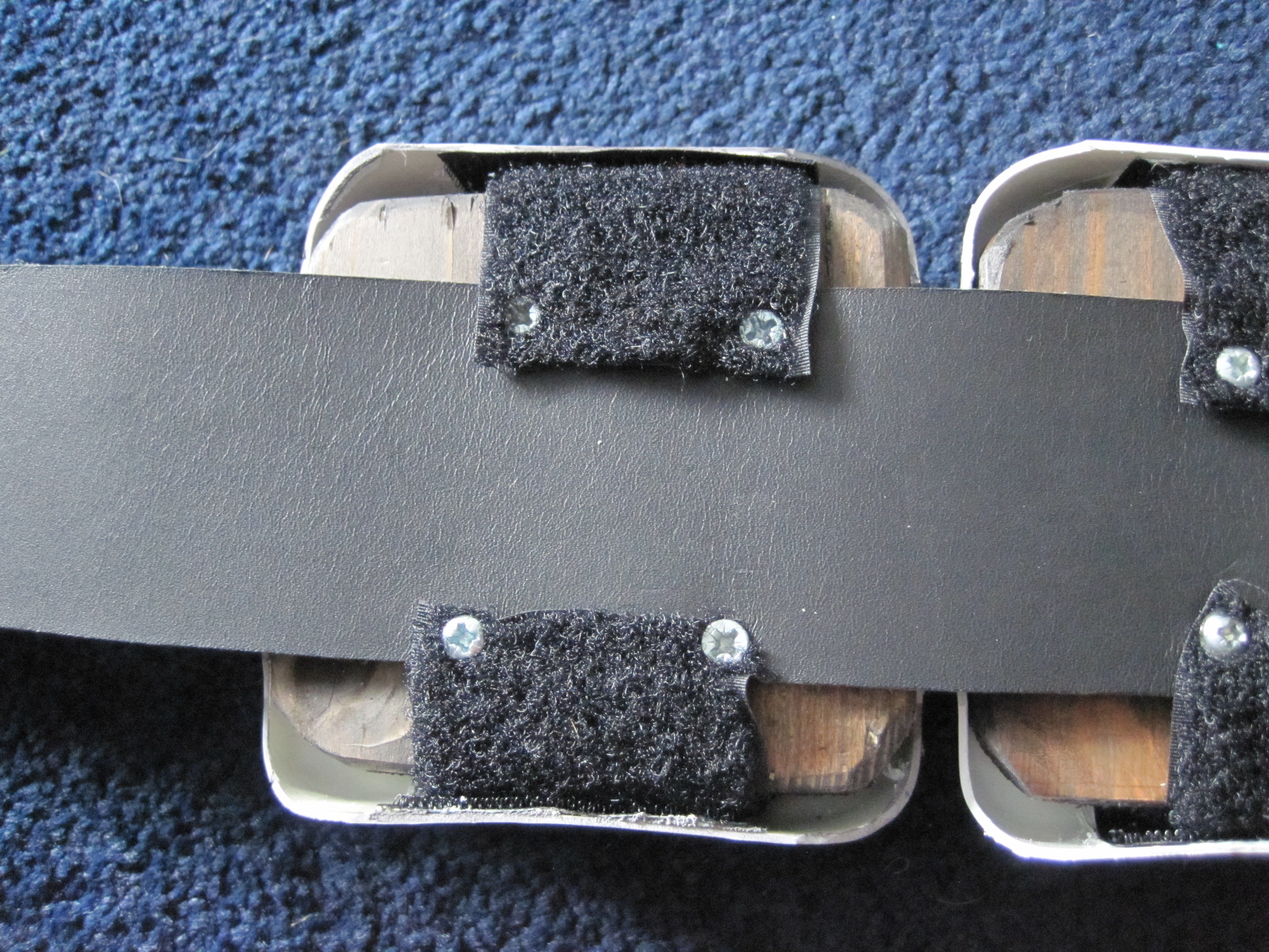

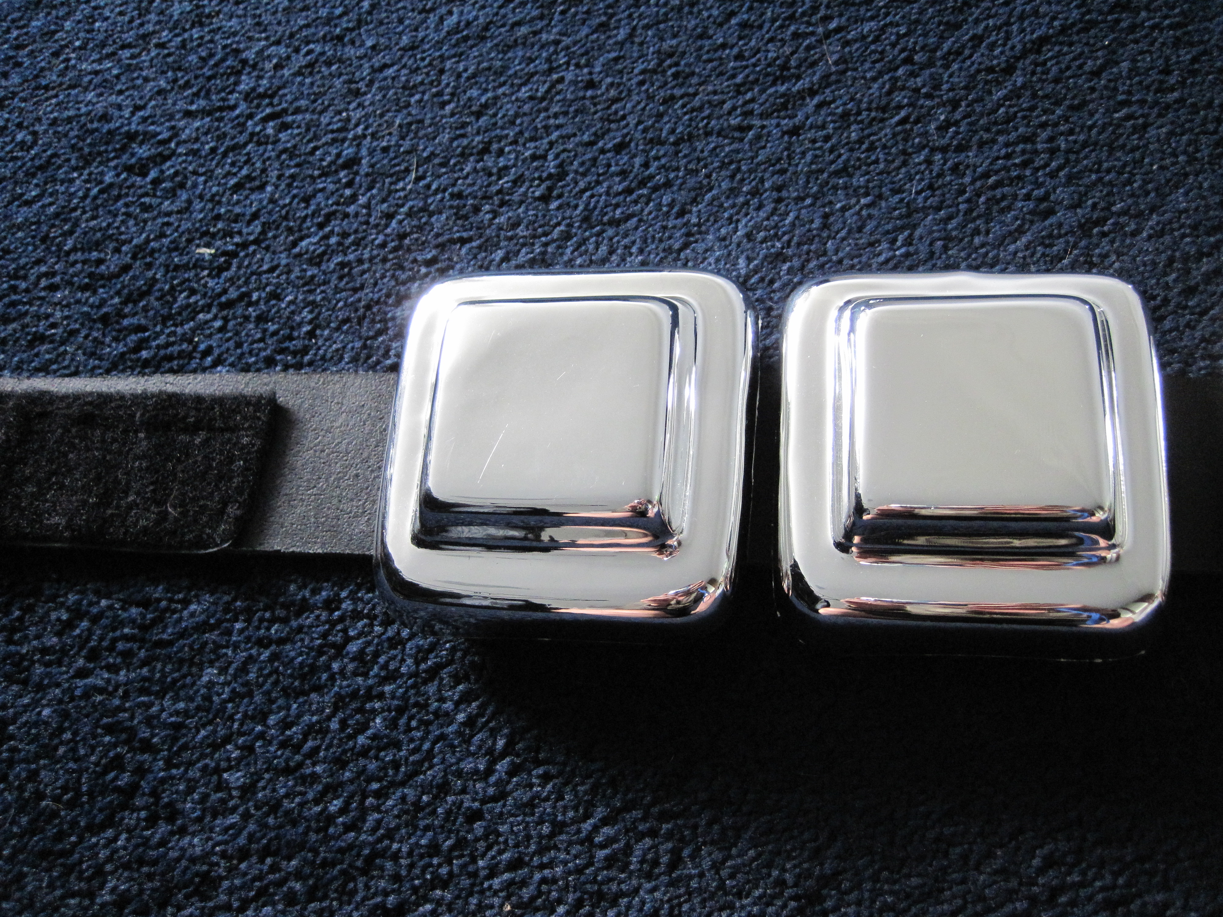

Belt Battery boxes detail. I bought a leather belt blank for about £15 and then used a sewing machine to add velcro so it now works as a belt.
I then added velcro in a wrap around the belt and screwed this into some wood squares.
I then used some melted ABS using acetone to fix some velcro inside the battery boxes and this enables them to fix to the belt. Sound and secure for wearing.

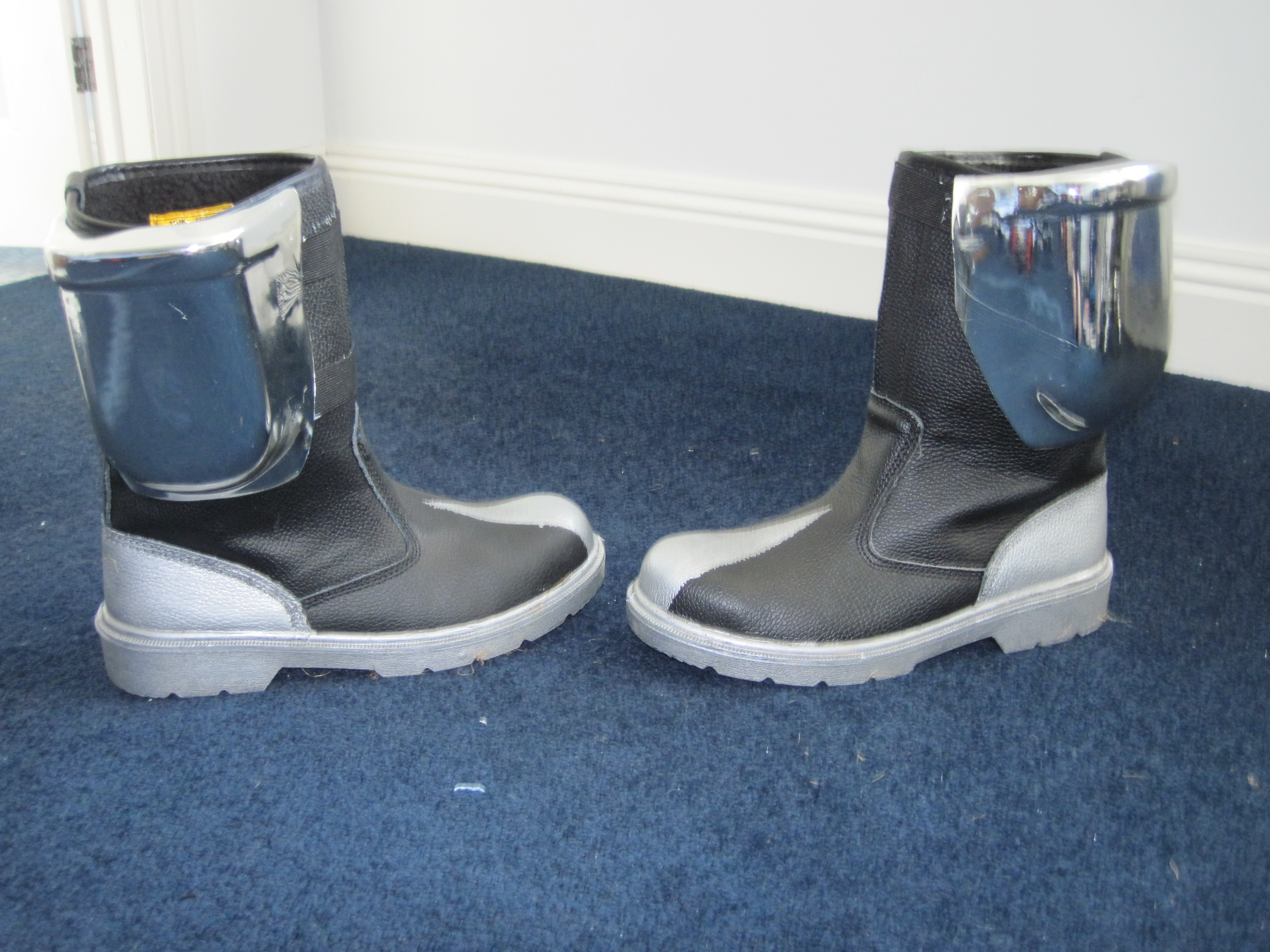

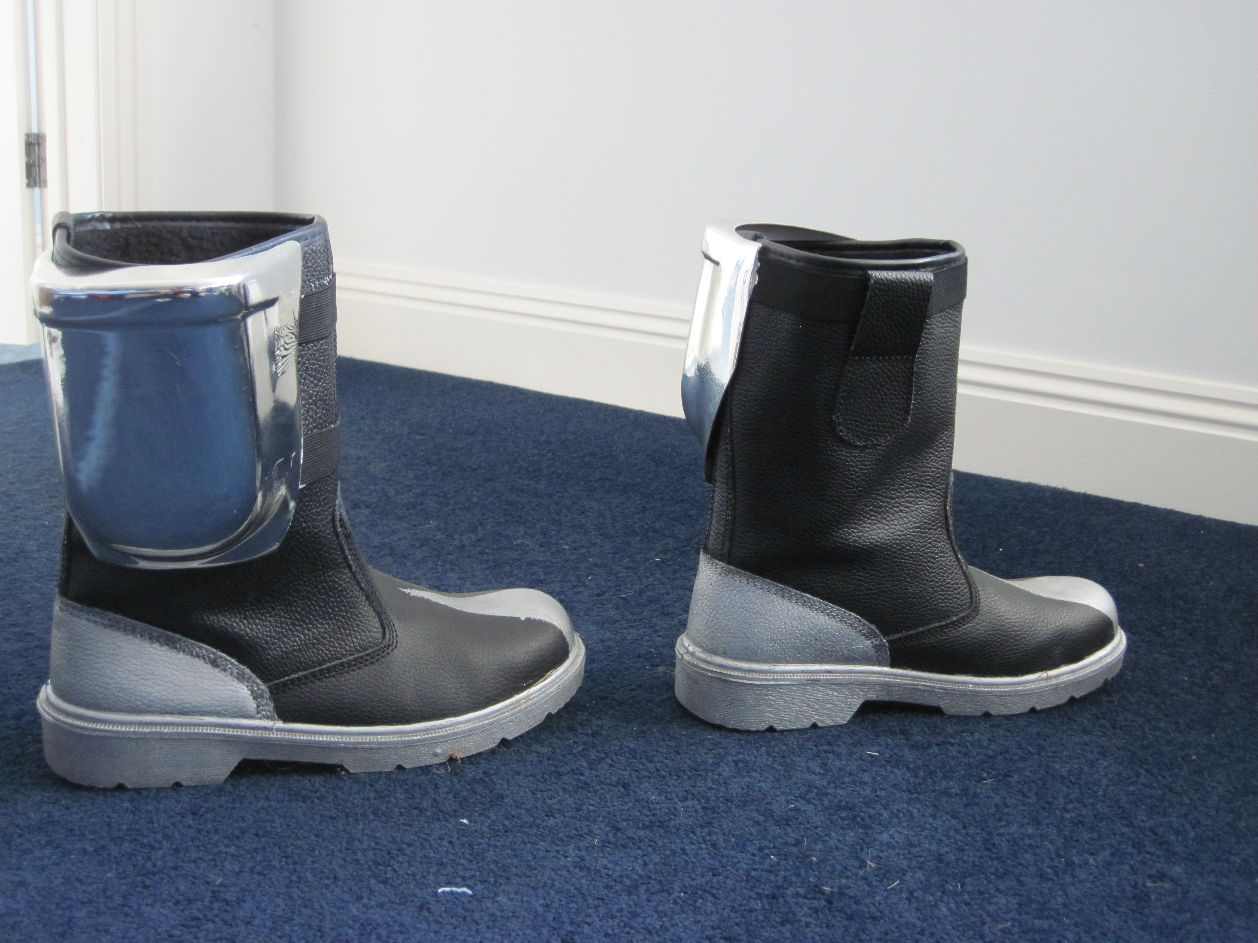

Boots are almost complete.
I have messed up a little bit with the ABS glue I have been using. You have to be careful it doesn't melt through and make the chrome go rippled. I did do it in stages and built it up, let it dry and then applied the glue again. It just seems if there is slightly too much and it hasn't fully dried then you can come back to it the next day and find a bit of a mess. Be warned! Lucky for me it is only on the boots where people won't be looking anyway. And also lucky for me any visible parts the gluing has worked perfectly so far. Painting the boots was a little tricky too as the paint run a little in the ripples of the leather. Again though it isn't a detail I am too worried about as you don't really notice it unless you can see right close up and that isn't very likely. I'm 6 ft and with the helmet and kit on most people will be looking at the red eye.
- dorns
- Phalanx Leader
- Posts: 100
- Joined: Thu Sep 26, 2013 4:26 pm
Re: A Cylon has landed!
If you look closely at the boots you can see the rippled bit where I attached some elastic to the boot. Disappointing for me, but a harsh lesson learned. I'm going to make sure that it doesn't happen again.
The Krop boots detail on the chrome isn't very accurate as for some reason they only make half of the section. I do have a solution for that and will add extra chrome in the future.
As for the paint running a little - I may go back over it with black paint. I have some on order and will neaten up the lines when it gets here.

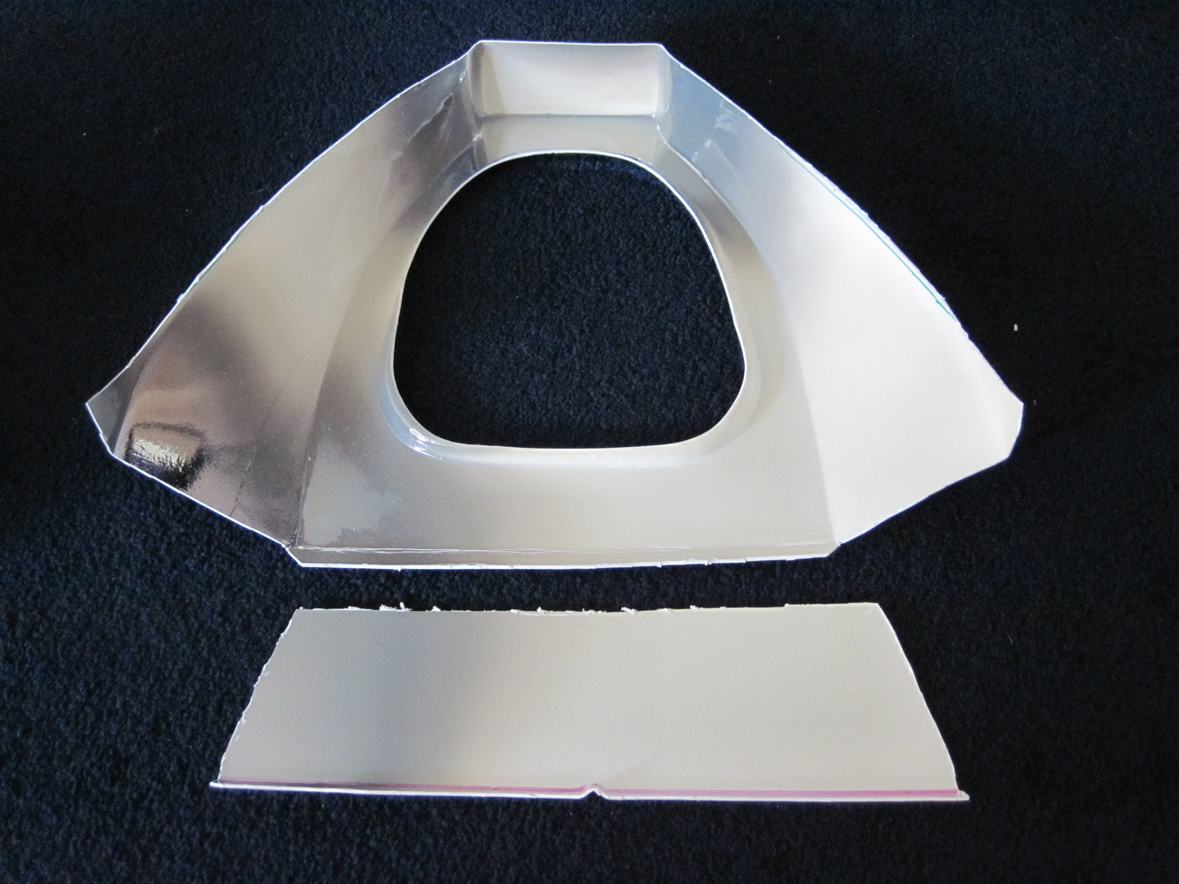

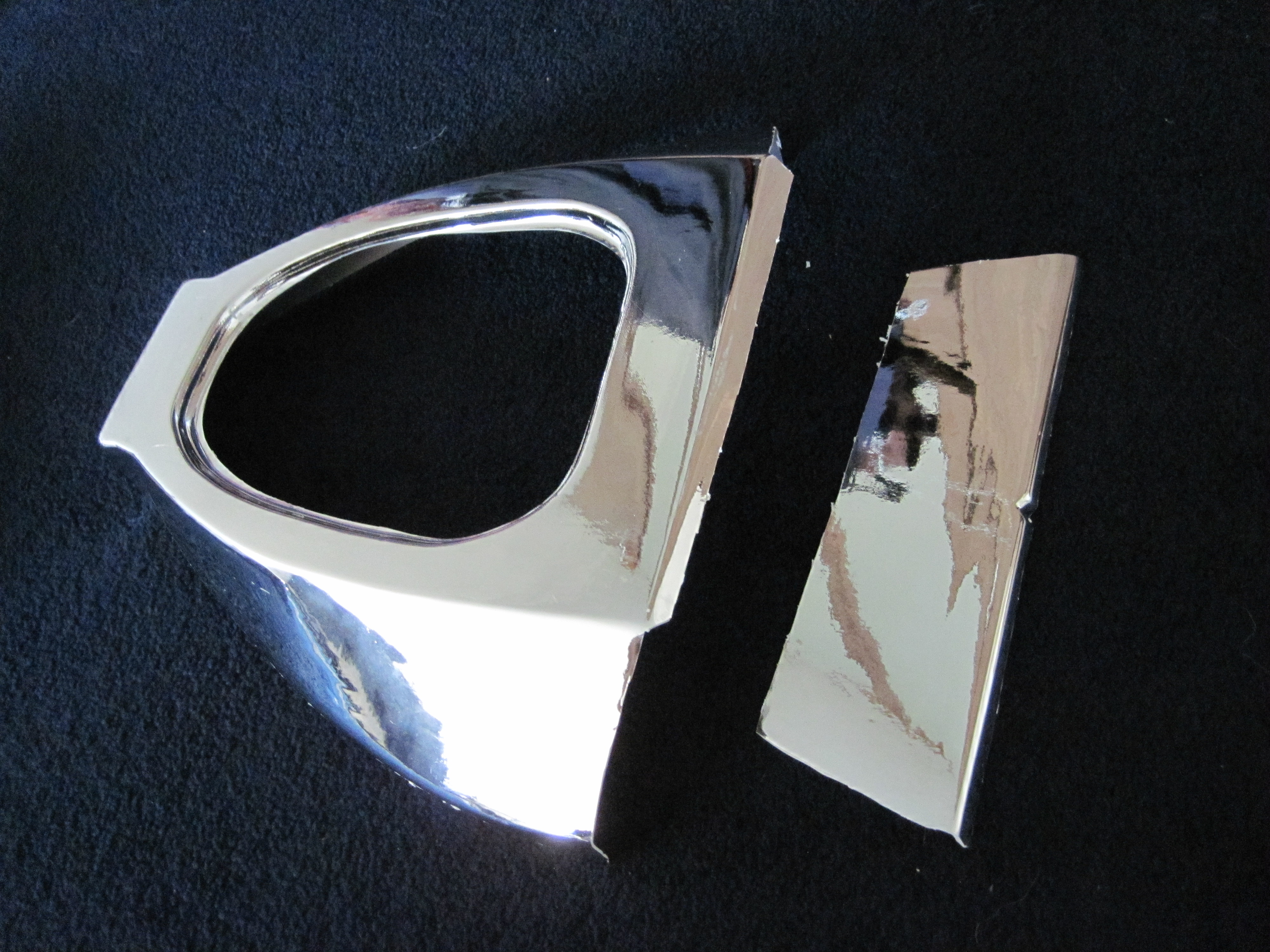

I have now modded the krop backpack. It was really annoying how the toilet seat jutted right out and the angle was badly off for wearing. I have cut it to a pleasing angle and it looks much better than a standard krop version. Closer to screen used. I am very pleased with it now. I need to get it all glued back together and then I will add photos of it completed. I can do some photos of the cut out pieces soon.
- dorns
- Phalanx Leader
- Posts: 100
Toilet seat cuts ready for assembling with back pack.

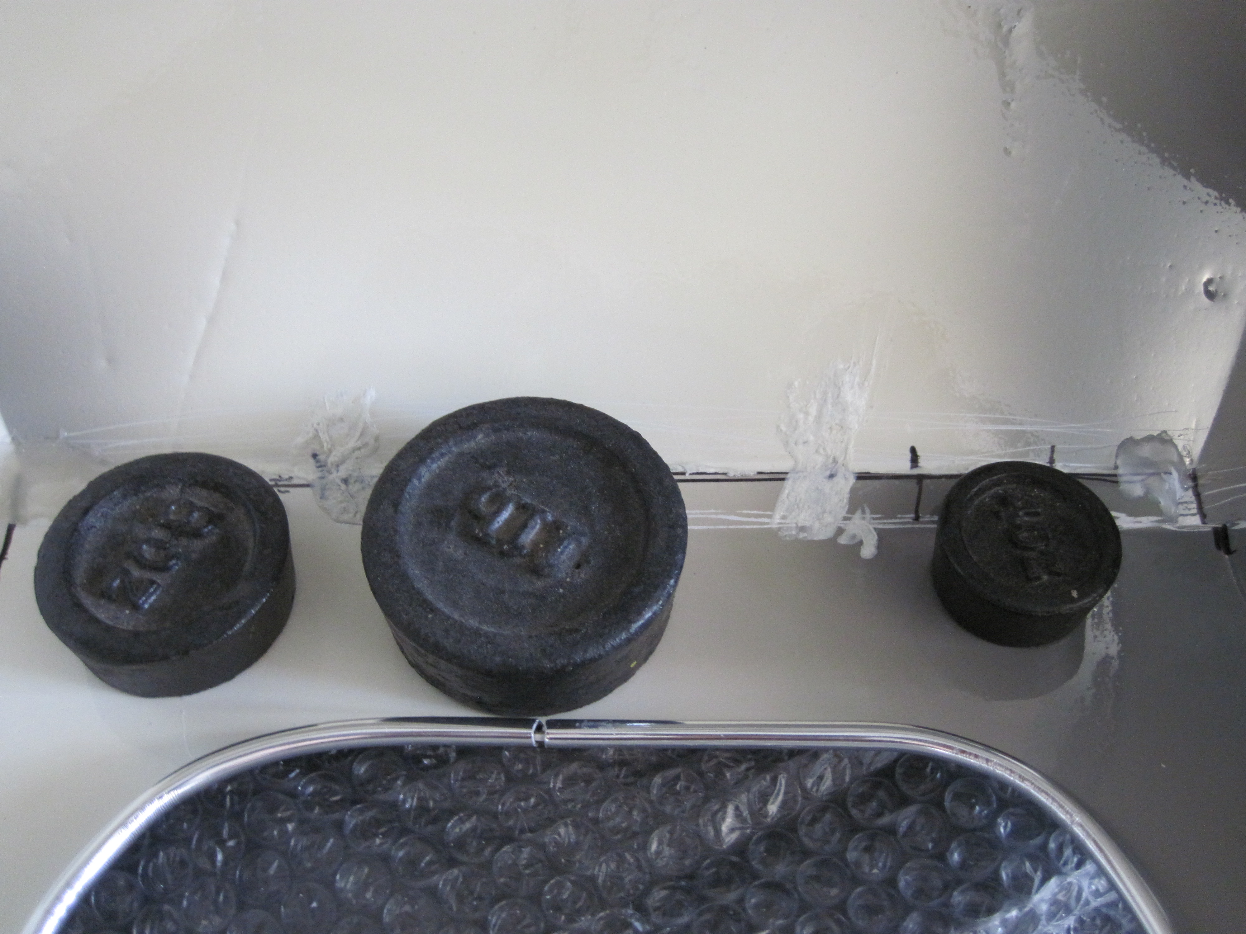

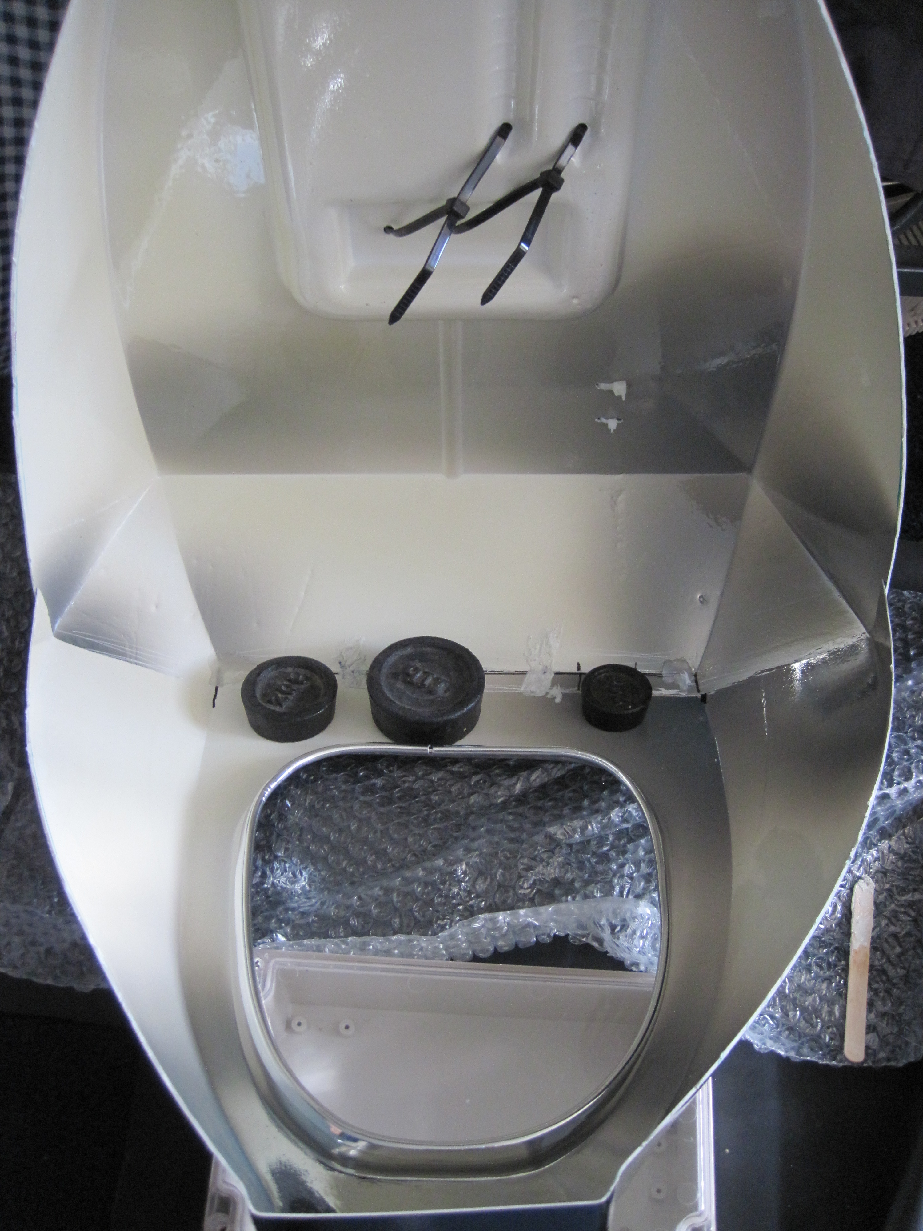

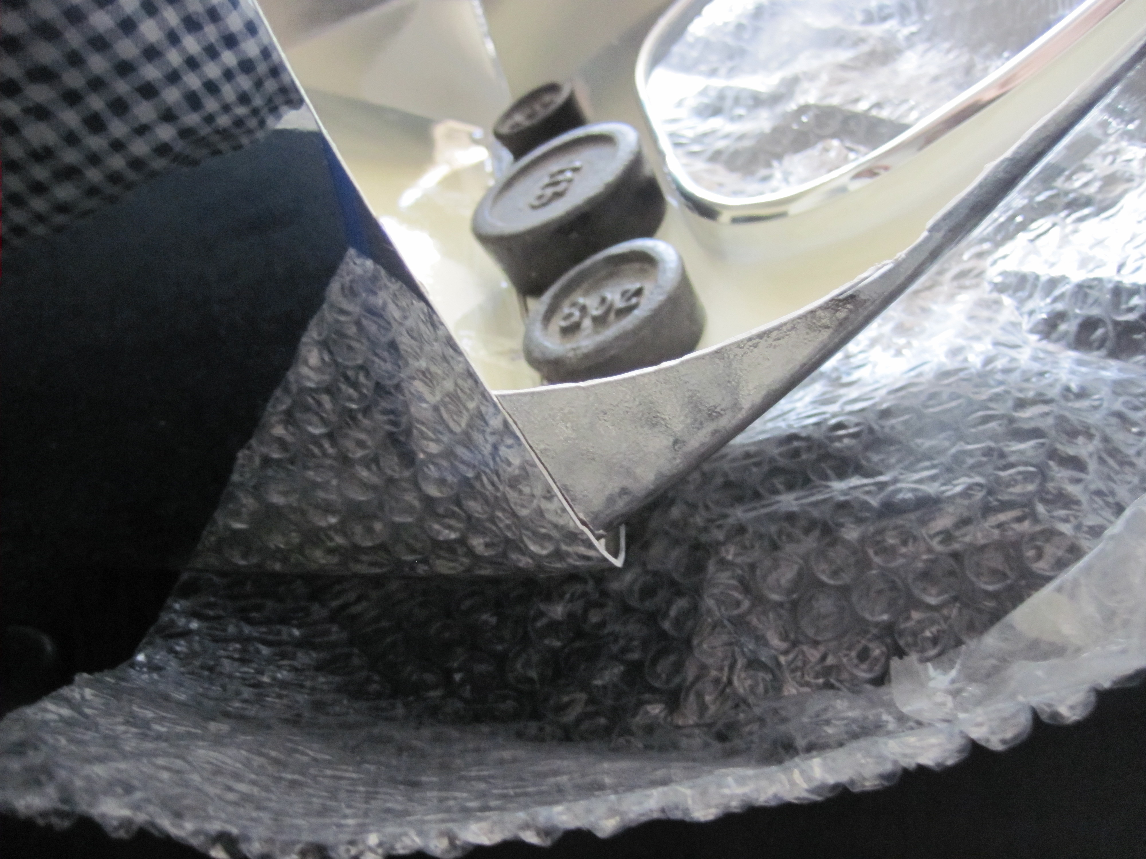

Thanks for the nice comments guys. It keeps my spirits high when I am working with all this ABS and chrome. Using a dremel to cut expensive ABS is something only someone with a steady hand can do.
Anyway - here is some more progress. Toilet seat, meet backpack. I also added some chrome rubber edge to the inside of the seat, makes a really nice rolled edge and should be ultra comfortable for wearing. Close up of the join and weights holding it in place while the hot melt and ABS slurry weld together. Side view, showing the new more accurate angle for backpack.
