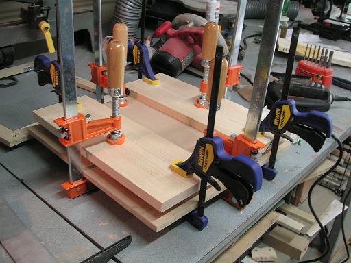

Volpin DIY Vacuum Form Machine Build
Ok it's been awhile since I added to this thread but I found this build while I was searching for Rototcast and Mold building information and I thought it was a great home made machine.
Harrison Krix, a graphic designer and propmaker from Atlanta AKA Volpin Props is a very talented guy who states very clearly he is a hobbyist and does not sell to many of his creations but in my opinion he is every bit as good as a hollywood vetran prop maker. If you look at his links and his flicker account he has built many different props some from video games like the N7 gun from Mass Effect 2 and the two Daft Punk helmets and many more.
I have never seen a build or builds that were so well documented!. The helmet builds he has done are the most intense complicated helmet builds I have ever seen! His photos take you through every step from creating the plugs to the final product!... His Flicker account has over 1800 photos of his builds and all step by step.
I am going to feature him on the Rotocasting thread but while I was searching all of his work I stumbled on his Vacuum Form machine build.
This is a great Machine and is real inexspensive to build and is used in conjuntion with other methods such as Rotocasting to achive the final products.

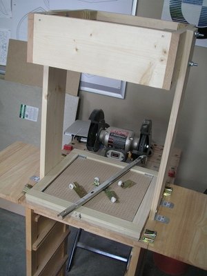

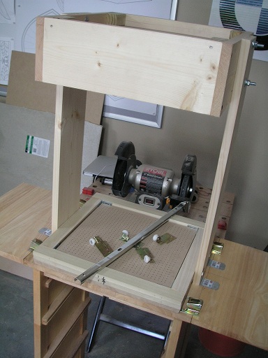

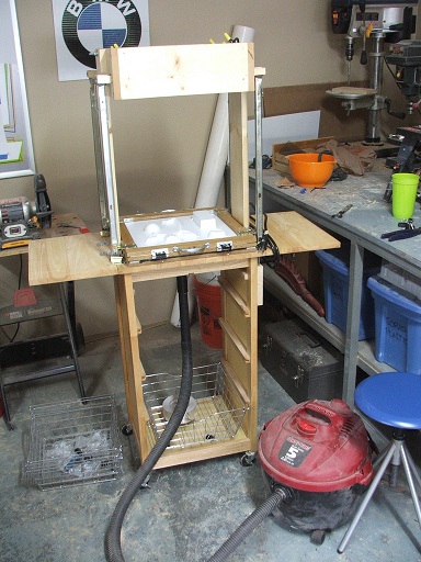

Volpin Props Vacuum Form Machine
Budget build mini vacuum-former
June 13, 2010

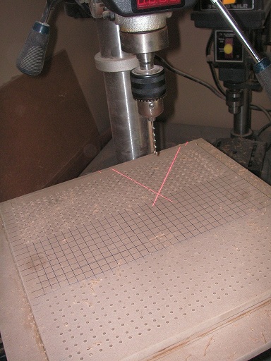

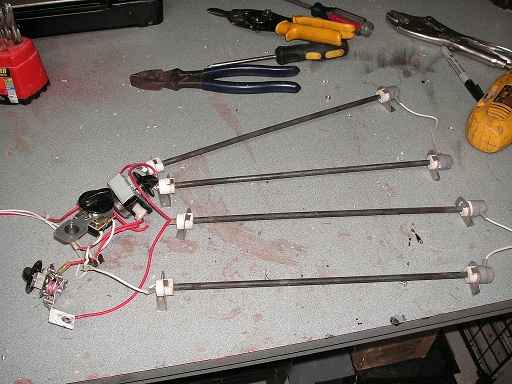

I have long wanted a vacuum-forming machine of my own, and after scouring tons of resources online, I finally decided to try my hand at it.
[attachment=6]Volpin Machine 1.jpg[/attachment]
My former is a little bit different from others I
June 13, 2010

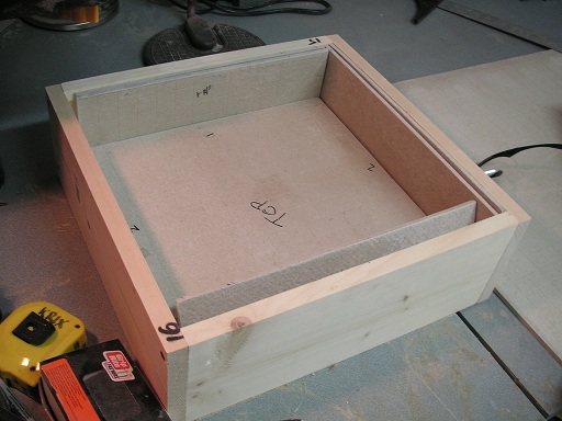

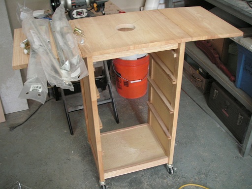

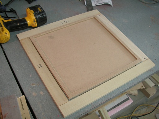

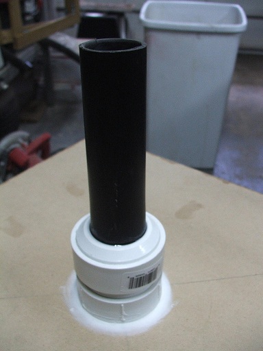

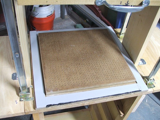

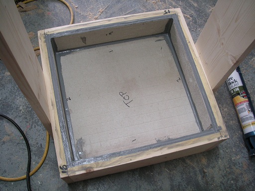

Volpin Machine Cont.

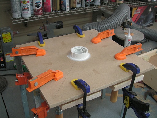

This is the cobbled-together adapter I

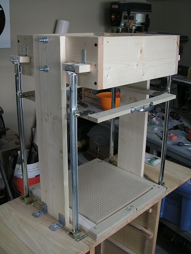

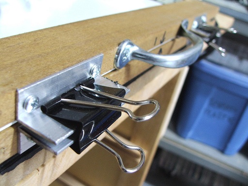

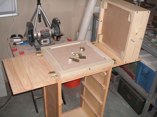

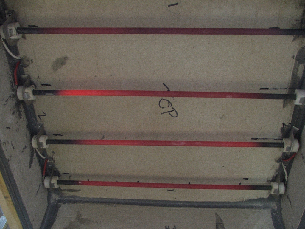

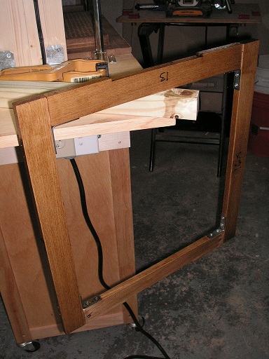

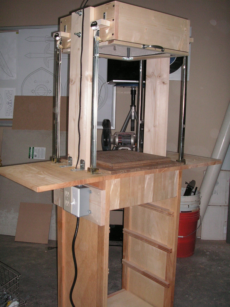

Volpin Machine Build Cont. 2

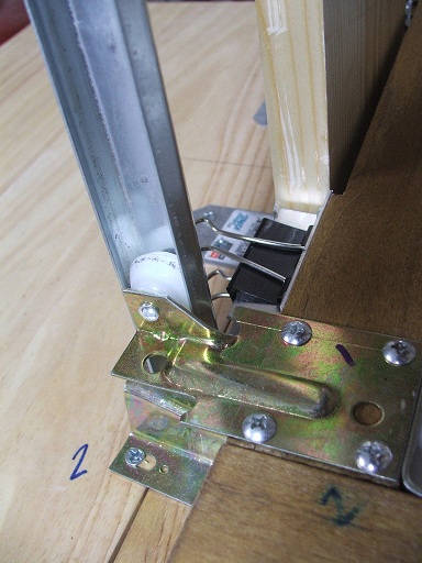

[attachment=6]Volpin Machine 15.jpg[/attachment]
I also stained and sealed certain pieces of the machine to protect them from wear and tear. The platen and frames were stained and sealed, while the oven and support arms got a coat of wood hardener.

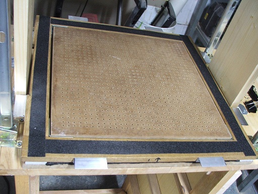

[attachment=5]Volpin Machine 16.jpg[/attachment]

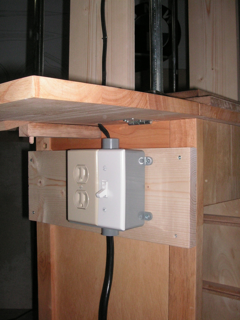

For power, I ran a grounded line to a distribution box with its own outlet. The switch here controls the oven, and the outlet is used for the vacuum and heat gun. Don

Volpin Machine Build Cont. 3

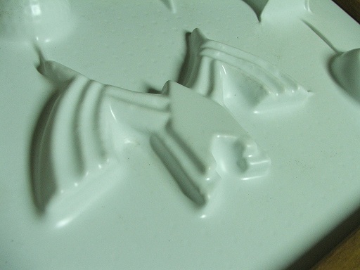

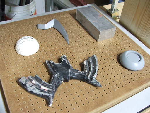

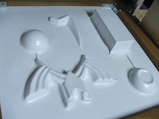

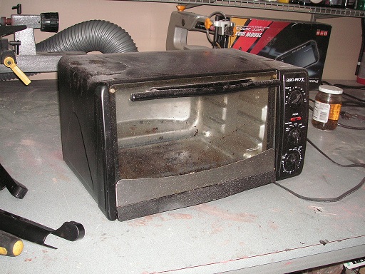

With that done, it was tine to melt some plastic! I grabbed some random junk from my shop and lined it up. Shown (clockwise) is:
1.A filigree piece from my Hylian Shield build
2.An aluminum block
3.The mold master puck from Chell
2.An aluminum block

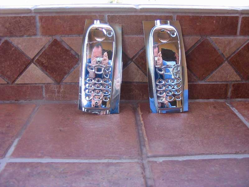

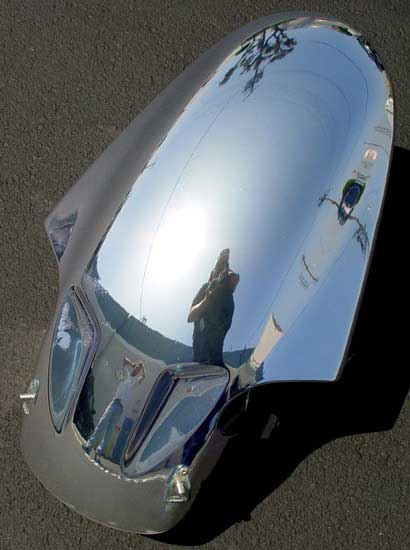

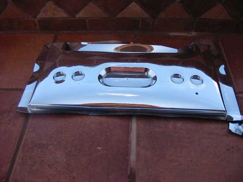

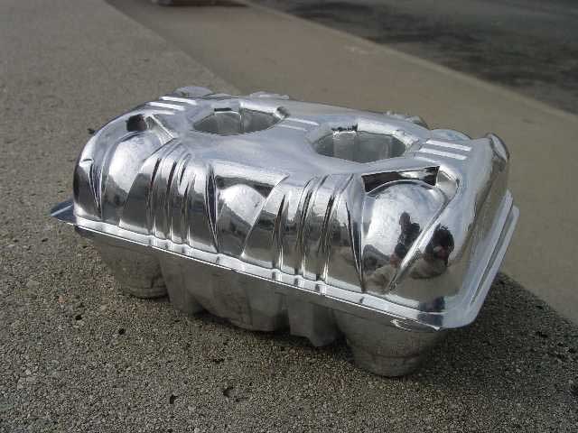

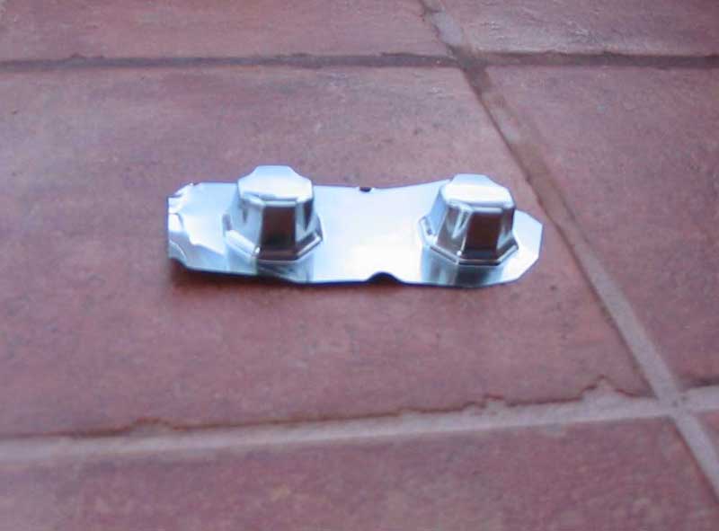

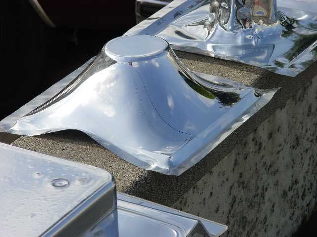

ALSA Corp Vacuum Formable Chrome Sheets
This disscussion started on another thread here at BYC and it was about another product ALSA makes "Peel and stick chrome film"...so I did a little research (went to their web site) and discovered they make several products for chroming.
Peel and stick film, Spray on chrome paint, Powder coating Chrome, and this one
Formable Chrome Sheeting
The plastic sheet is a laminate of Petg, Chrome (Mylar) and a black ABS backing sheet.
Available in thicknesses of .30 to 1/2 inch
Samples of Formable Chrome
[attachment=5]frmblchrm_01.jpg[/attachment]
[attachment=4]frmblchrm_06.jpg[/attachment]
[attachment=3]frmblchrm_11.jpg[/attachment]
[attachment=2]frmblchrm_12.jpg[/attachment]
[attachment=1]frmblchrm_14.jpg[/attachment]
[attachment=0]frmblchrm_15.jpg[/attachment]
You should look at their video demos on their web site as they also make a chrome paint that is awesome!

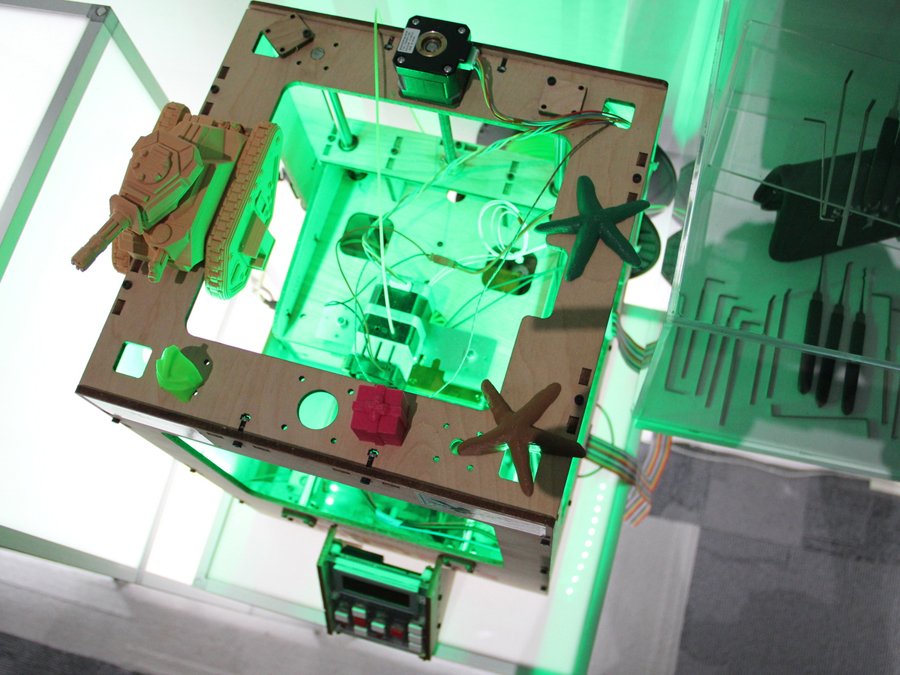

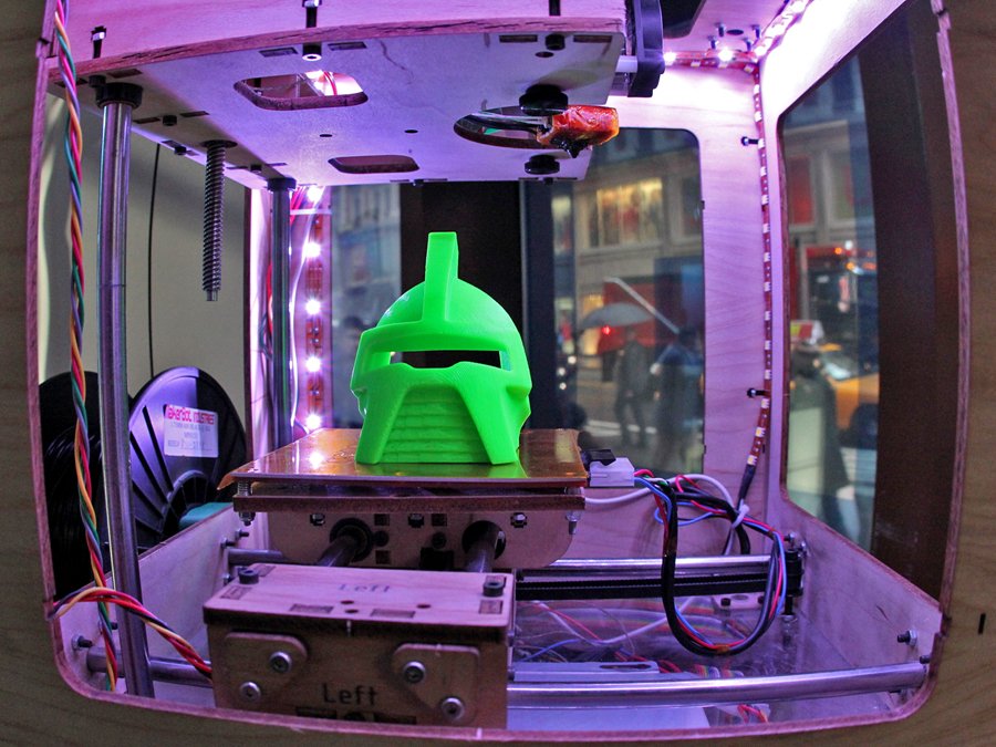

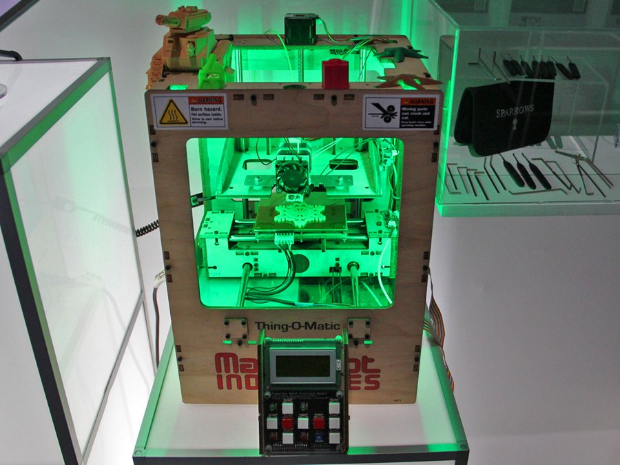

3D Printer for making parts
Daniel Goodman | Dec. 22, 2011, 9:22 AM
The Wired Store at Times Square and 42nd St is closing on Saturday, and if you can you should go check it out. If not, don't worry, we got the goods for you right here.
