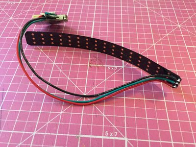

I haven't seen this solution posted yet, but I'll be using this in my current Centurion build.

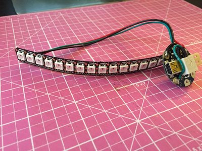

Adafruit has complete instructions for a Larson Scanner project powered by their tiny Trinket or Gemma boards - instructions and parts list is here https://learn.adafruit.com/larson-scann ... s/overview.
My eye slot fits 17 LEDs, so that's what we built and programmed around.

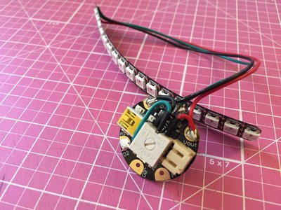

A friend who's a lot who's a lot handier than me did the soldering, and added a pot so the speed of the scanner can be changed with a twist of a screwdriver.
He also modified their code to create a "comet tail." I've attached a zip file with a modified .ino file if anyone wants to take a look.
The LEDs are *very* bright, but that can be modified in the code. Planning to put a blackened lens made of milk jug plastic to darken and diffuse the light (you can see a mockup of how that will look in my profile pic).
Not the cheapest solution, but it won't break the bank :D
Here's the eye:

If you follow the instructions on the Adafruit site, it'll tell you how to adjust the speed by modifying the program you load into the Gemma board.
However, we added a pot on top of the Gemma board to manually control the speed. Thought it would be easier to give it a twist with a screwdriver than reload the software any time we wanted to speed up or slow down the eye sweep.
