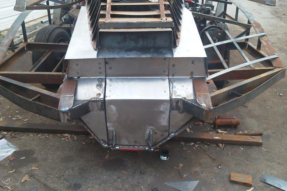

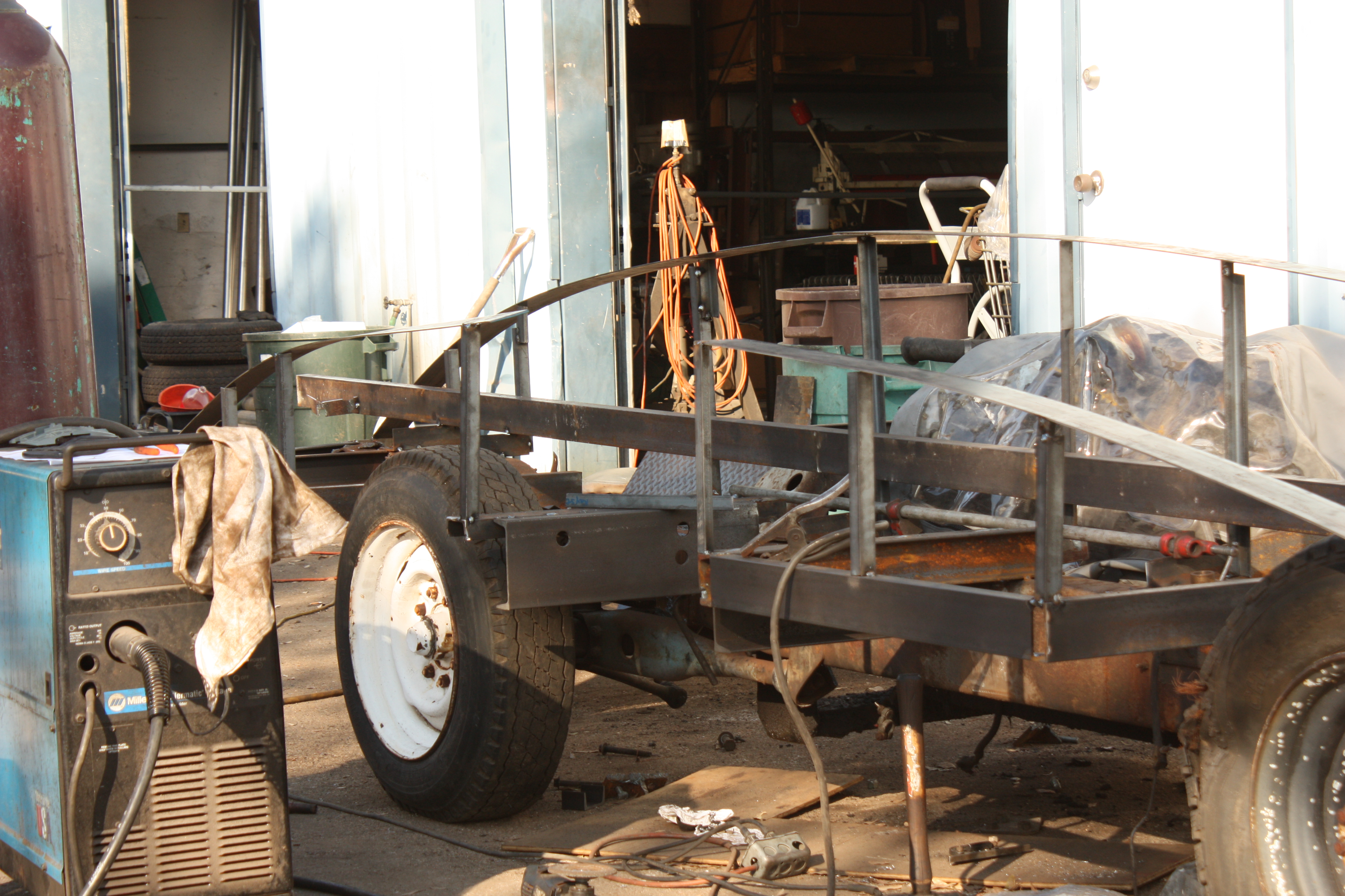

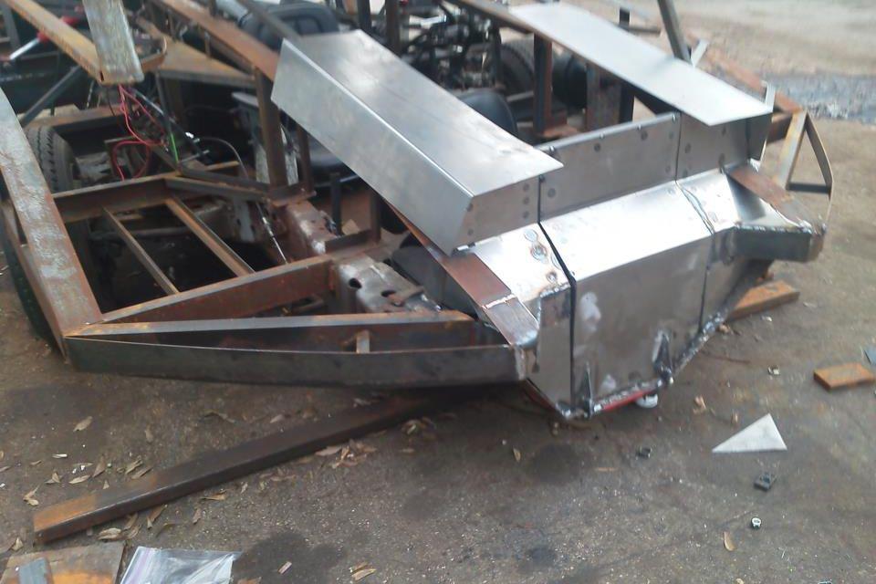

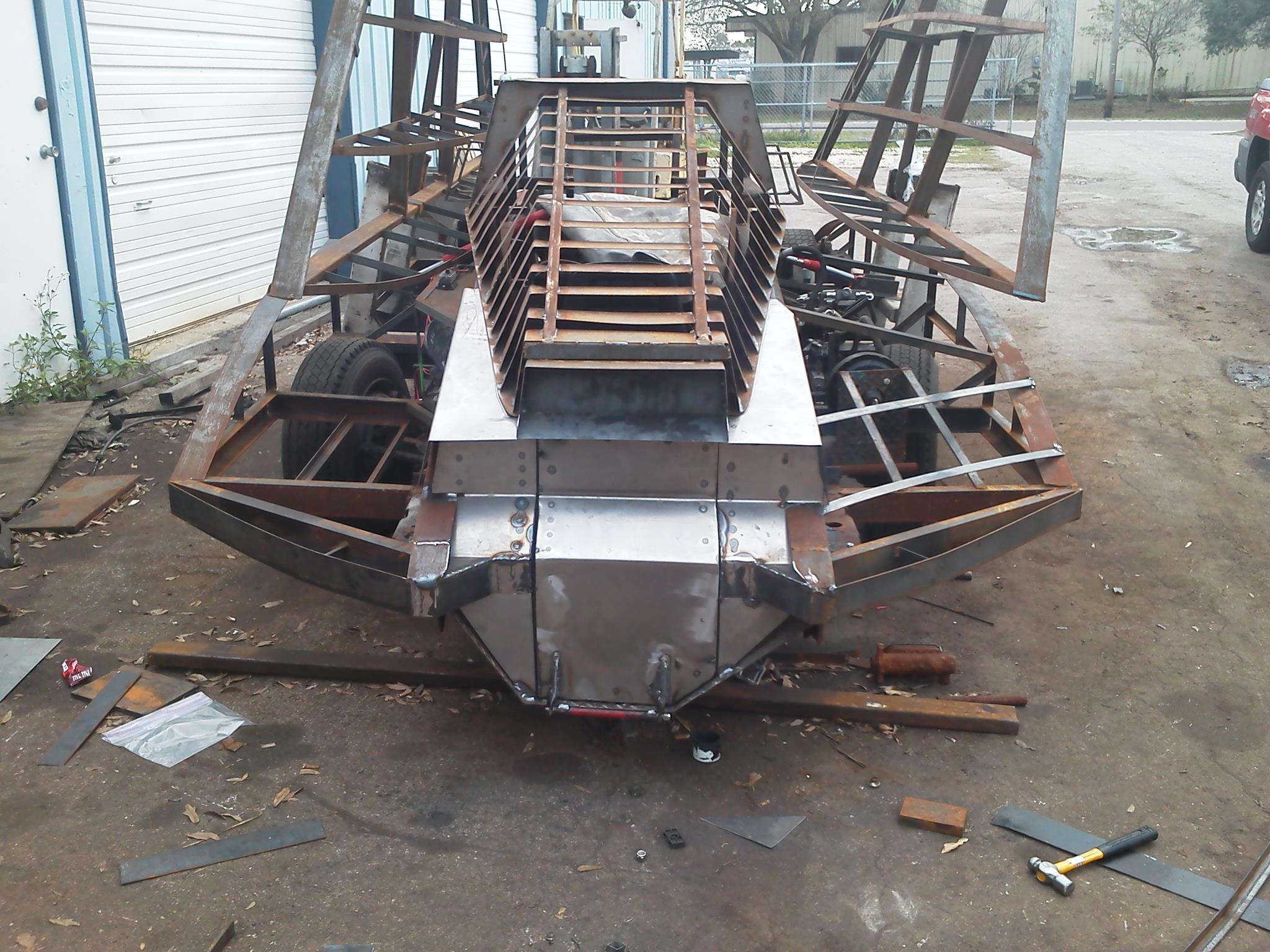

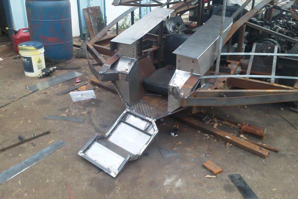

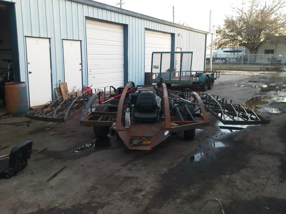

Good morning Dale. The timeline is as follows
In September of 2012 after a meeting of the CCA advisory board we decided to move forward with the Raider project.
On October 10th the chassis we decided to use was delivered to our facility in Pinellas Park Fl.
The base chassis is a 1978 Cochran Airport Systems model 660 belt loader that was originally a e350 ford chassis. These are used on the airports to load baggage into the aircraft.
The decision to use this chassis was mostly because in a belt loader the engine is at the center of the chassis but in addition it already has a hydraulic system to start with.
We spent $1,100 purchasing the unit and $800.00 in freight getting it here from New Orleans La.
We began disassembling the unit on 10-12-12. Removing the body and sheet metal as well as all electrical and hydraulics. Till we had nothing but a frame and 2 axles.
The axles were removed and the suspension was removed. Then the axles were reinstalled in a solid position so there would be no wobbling of it after it was finished,
At this point we had about 52 hours into it.
Since then we have been assembling and building and have at least another 150 hours of time
Total spend so far is Approximately $1,900 Purchase
$2,800 in steel
$4,200 in hyd cylinders, valves and hoses.
$500.00 in switches, wiring and solenoids
$9400.00 total so far

Below is a few photos of the build.
